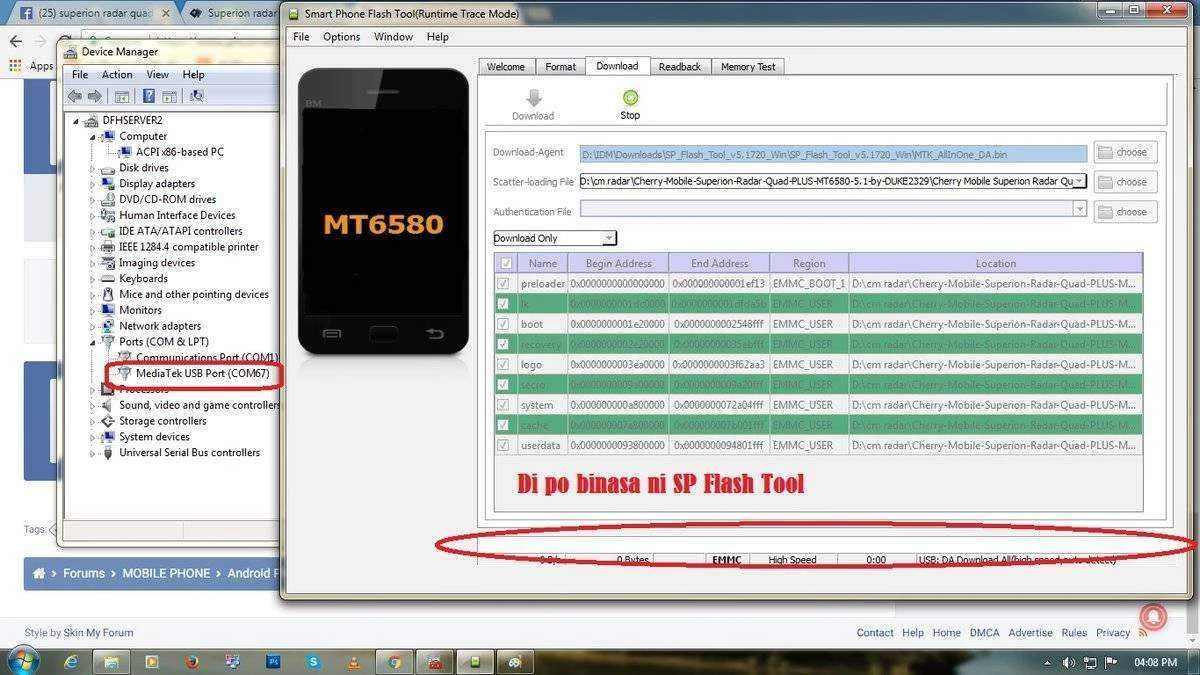

sir magandang hapon. yung Cherry Mobile radar quad plus ko nadedetect ng PC yung MediaTek USB Port pero di binabasa ng sp flash tool.
