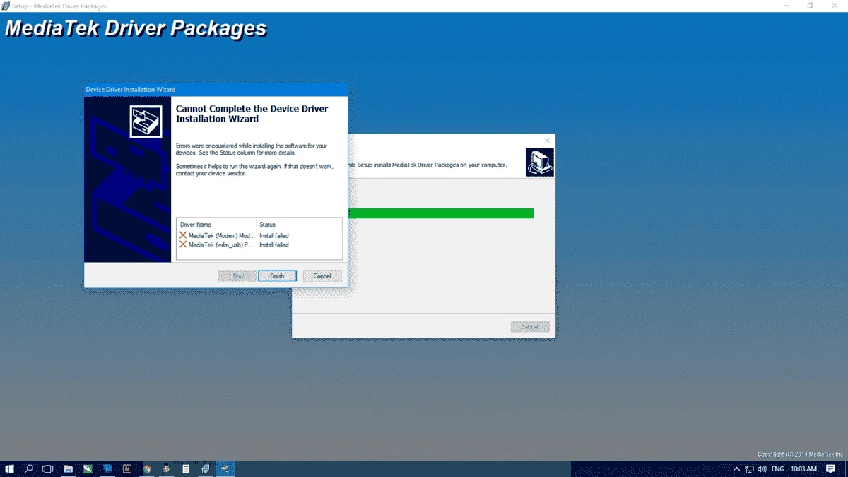

MT65XX USB Vcom drivers - eto makukuha nyo kaagad sa google :)

2.Install MT65xx Preloader driver.

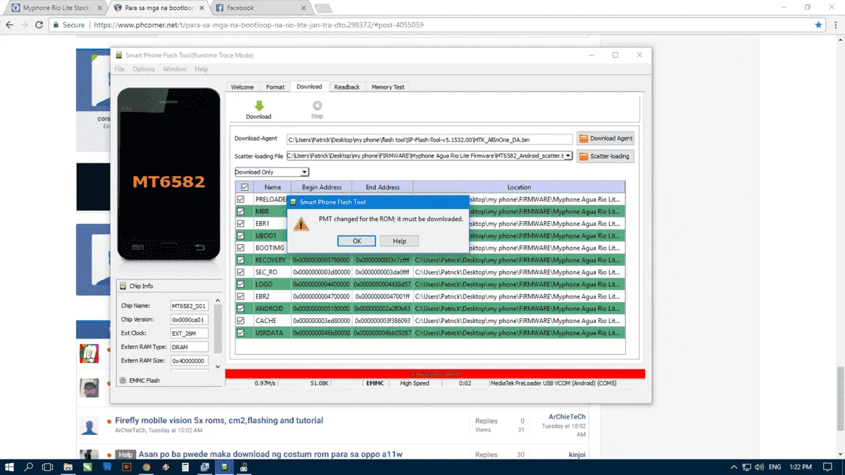

3.Open SP Flash tool folder and run as ADMIN flash_tool.exe.
4.Browse the scatter file from the MYPHONE RIO LITE FOLDER firmware folder.
5.Click Download button. Turn off your smartphone.
6.take off the battery and simcard SD card,Hold volume down then plug your device to the computer.
7.The process should now start once you see a yellow progress bar and release the volume down.
8.Wait for the process to finish.
9.ilagay ang sim at sd card para hindi mag loko then restart now you cp. boom!!
It takes 15 – 20 minutes to boot successfully, please have a patience.
if error has pop out..
1.punta sa format...click start format
2.press vol.down again in your RIO Lite and connect to the computer.
3.wait until its shows green bar and it will pop out finish formating.
4. again take it off,and go to scatter file locate the folder
5. press download
6.press vol. down in your RIO Lite and connect and hold it until the yellow pop out until 5%
and release the bottom
7. wait until it says OK
8. ilagay ang sim at sd card para hindi mag loko then restart now you cp. boom!!
