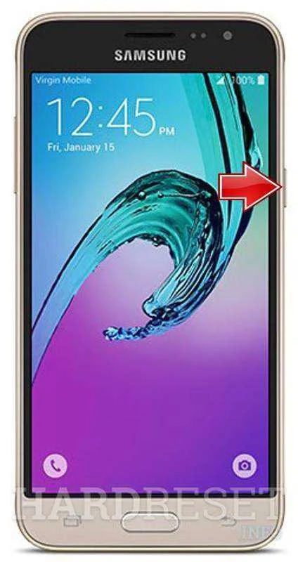

  1. Frist of all, switch off the cell phone by pressing the Power button.samsung-j320p-galaxy-j3-2016.webp

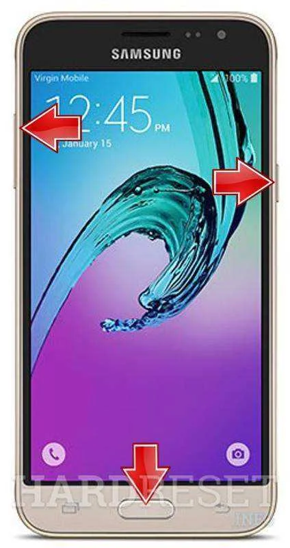

  2. Afterwards press and hold together: Volume Up + Home + Power key until you see Samsung logo.samsung-j320p-galaxy-j3-2016.webp

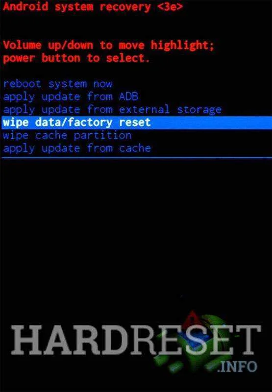

  3. Then select from Recovery Mode menu "wipe data / factory reset" using Volume buttons to navigate and Power button to confirm.samsung-j320p-galaxy-j3-2016.webp

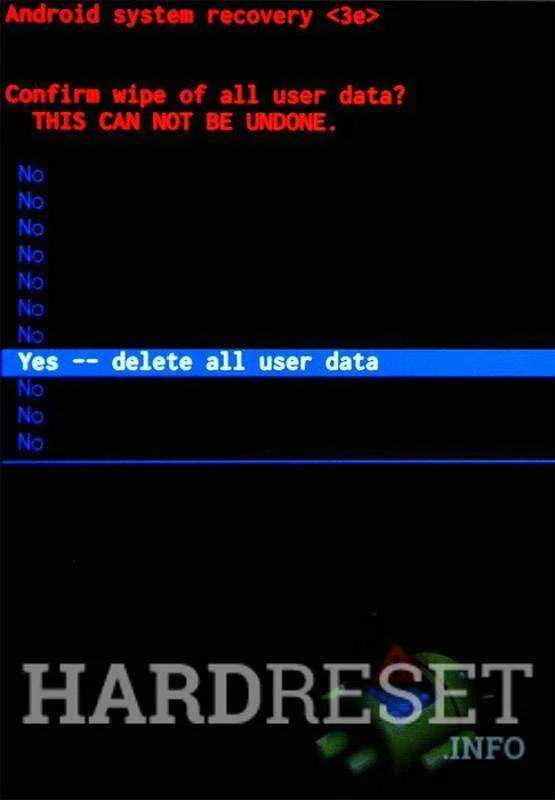

  4. In the next step choose "Yes -- delete all user data" to confirm the whole operation.samsung-j320p-galaxy-j3-2016.webp

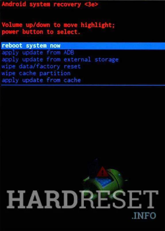

  5. After that select option "reboot system now".samsung-j320p-galaxy-j3-2016.webp
