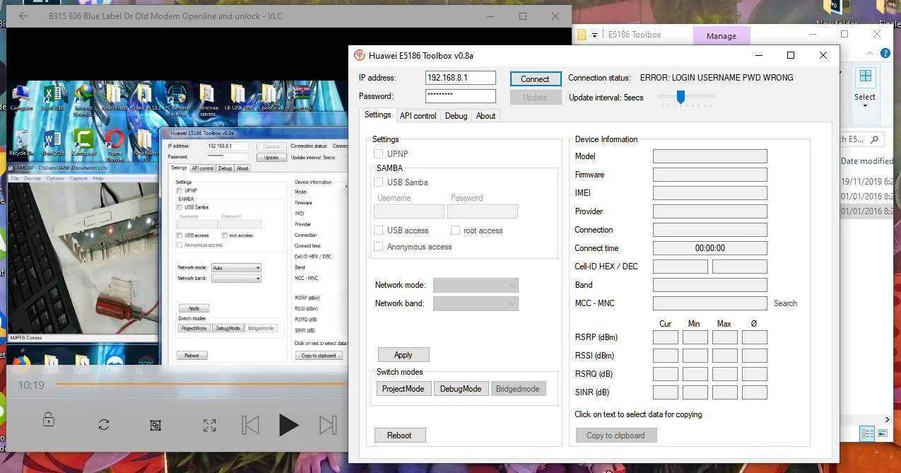

1. Open B315s toolbox
- admin admin
- API Control
- api/device/mode
<request>
<mode>2</mode>
</request>
- Write Directly to API
- Click Debug, check kung ang response ay OK
