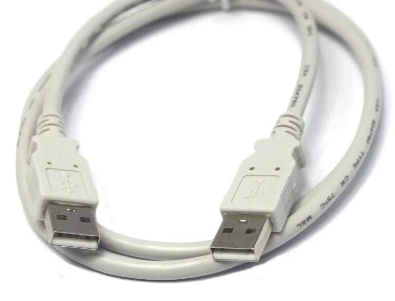

una kelangan mo ng ganito
usb data cable male - male

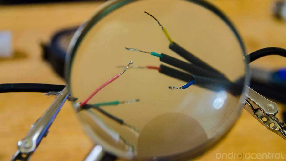

kung wala . pede kang gumawa kumuha ka ng dalwang usb charging cable
cut mo lang tapos pag duksungin ayon sa colors

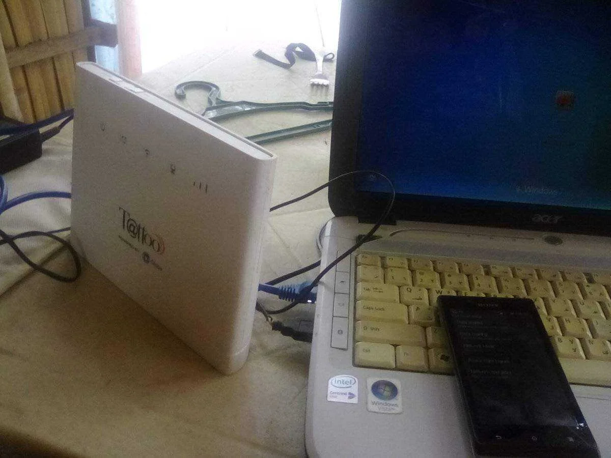

Preparation...
Plug flasher baklasin mo yung modem tingnan mo yung pic pag dikitin mo yung 1&2
Plug Power pag d umilaw bitawan muna pero kung umilaw ibig sabihin d nag dikit yung dalawang bilog ulit ka
Plug USB
1. Open Balong USB Downloader
- Click Detect
- Locate usblsafe-b315.bin
- Load
- Pag 100% na close.
2. Open Firmware Folder
- Click go_hdlc
- Enter
3. Open Huawei R215 Flash
- Locate 3G PC UI Interface (select)
- Flash
- Locate .hmf file
- Antayin na may nakasulat na Done/Remove battery and put it again..
- Close
4. Unplug Power, Unplug USB, unplug Flasher
5. Plug Power Chord, Plug LAN cable
6. Sign in 192.168.8.1 admin/admin
