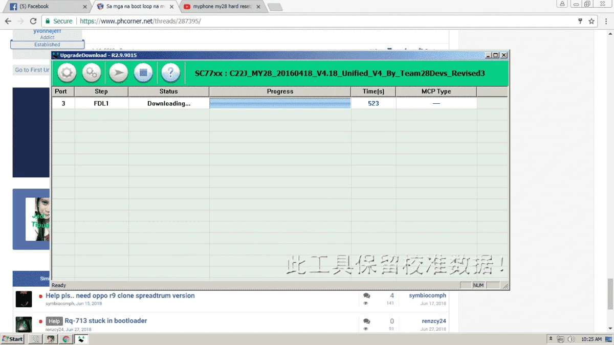

guide namn tayo how to flash:
  • Create a folder in your desktop and place all the files you’ve downloaded.
  • Open SPRD NPI USB Driver > Production Line Version >Choose “amd64” if you’re using 64 bit * choose x86 if you’re using 32 bits (After this steps install the driver that is compatible with your PC).
  • Open Upgrade Download (You can locate it in the SPRD Upgrade Tool Folder). Run it as Administrator.
  • From the main screen of Upgrade Download Tool, click Load Packet.
  • Find the extracted folder of C22J_MY28_20160418_V4.18_Unified_V4_By_Team28Devs_Revised3.pac and click the pac file (Wait for a few seconds until the pac file will load).
  • After loading the pac file, click Start Downloading (Settings or Gear icon).
  • Turn off your smartphone and remove the battery and insert it back.
  • Hold volume up and down simultaneously then plug your smartphone to PC using the USB Cable.
  • Release the volume – and + button once you see the message “In Progress”.
  • Wait for a few minutes. You will see the word “Passed” upon successful flash operation. You can now remove your smartphone from the computer.

Kapag nasa stage ng In Progress nag FFAILED na po sya. Nag ttry po akong ibang ROM kasi yung unit ko po is
MY28S not MY28. So baka po dun may problem?
