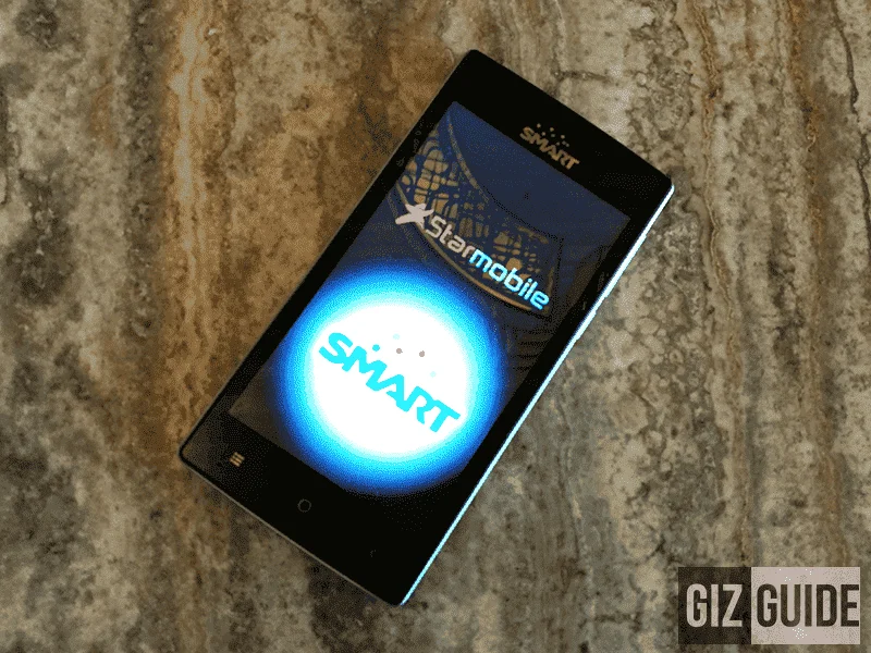

Most of the starmobile play click are lock in smart, so lets unlock it through some procedures without flashing. it is safer to use this method than flashing firmware. here are some few step to unlock;
Requirements:
Wifi Connection
KingrootV4.93.apk
Terminal Emulator_1.0.70.apk
wfixnv1.jpb
wfixnv2.jpb
Download it all once
Instruction:
0. Copy all above files to your SDCard (Memory card) directory
1. Root your phone using KingrootV4.93.apk or any rooting process you know,
2. Install Terminal Emulator_1.0.70.apk
3. Open Terminal Emulator and type su Then allow if popup appear
4. Follow carefully this command in Terminal Emulator:
su
enter
dd if=/mnt/media_rw/sdcard0/wfixnv1.jpb of=/dev/block/mmcblk0p5
enter
dd if=/mnt/media_rw/sdcard0/wfixnv2.jpb of=/dev/block/mmcblk0p6
enter
5. Restart! and done
