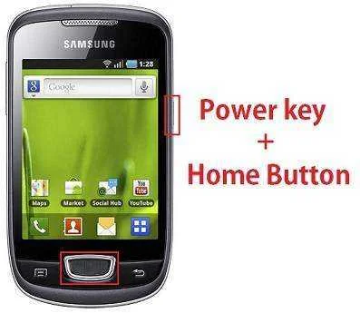

Step 2: Disconnect your Mini/Pop from PC and switch it off completely.

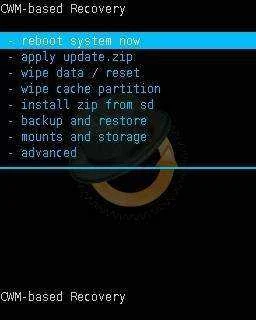

Step 3: You need to enter into the recovery mode now. For that hold ‘Home Button (middle button) + Power Button’ simultaneously until the recovery mode appears.
Note: Touch won’t work in this recovery. So use your device Volume Up and Down keys for navigation and Home button for selection.

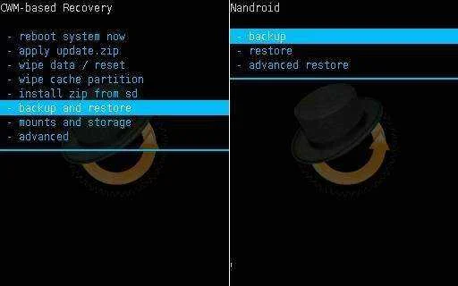

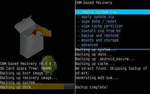

Step 4: If this CM 10.1 ROM fails while flashing or some problem occurs and you want your previous ROM (the one you are using now) back, then a Nandroid backup feature of CWM will help you out. Nandroid backup is the backup of your entire operating system & helps you easily restore the saved previous ROM from the CWM recovery in case of some emergency.
Refer our detailed article for taking Nandroid backup:
  1. You do not have permission to view the full content of this post. Log in or register now.
For doing same, navigate to the ‘backup & restore’ option on the recovery mode itself and on the next screen select ‘backup’ option. This will make a complete nandroid backup of your current ROM. Refer the screenshot given below.

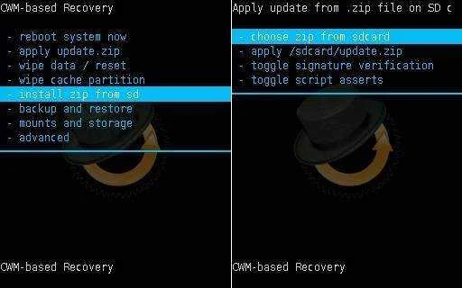

Step 5: After taking proper nandroid backup, again return to the main menu of recovery mode and select the ‘install zip from SD card ‘ option located on the recovery mode itself. Then on the next screen select ‘choose zip from SD card’ option. This will show you all the files and folders present on your external SD card along with Android 4.2.1 ROM package which you’ve copied earlier. Select it using home button. On the next screen, press ‘Yes’ option to begin the actual ROM flashing process. It will hardly take 5 to 10 few minutes to complete. Be patient until the process is completed fully.

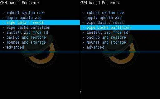

Step 6: After successful flashing process, again return to the main menu of recovery mode and select ‘wipe data/factory reset’ option followed by ‘wipe cache partition’ option which will clear all your data & caches from your phones memory.

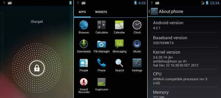

Yeepi! You have successfully installed the Cyanogenmod 10.1 ROM running on the Android 4.2.1 on Galaxy Mini/Pop S5570. You can verify the same from Menu->Settings->About Phone. Enjoy the amazing features of Cyanogenmod. Do tell us your views and experience after using the same. I have made this article so simple that even a newbie can understand it properly, still if you have any doubt or query regarding the same then you can inform us through the comments provided below. We’ll help you out. Till then Enjoy!
