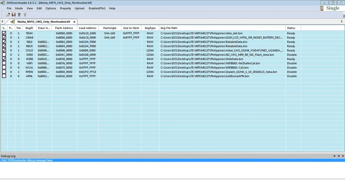

1. Download the firmware from the link below:
2. Reflash your firmware according to the procedure of Sir Argotron (https://phcorner.org/t/smart-bro-evoluzn-fx-pr2l-unlocking-reviving-update-12-01-16.216720/)

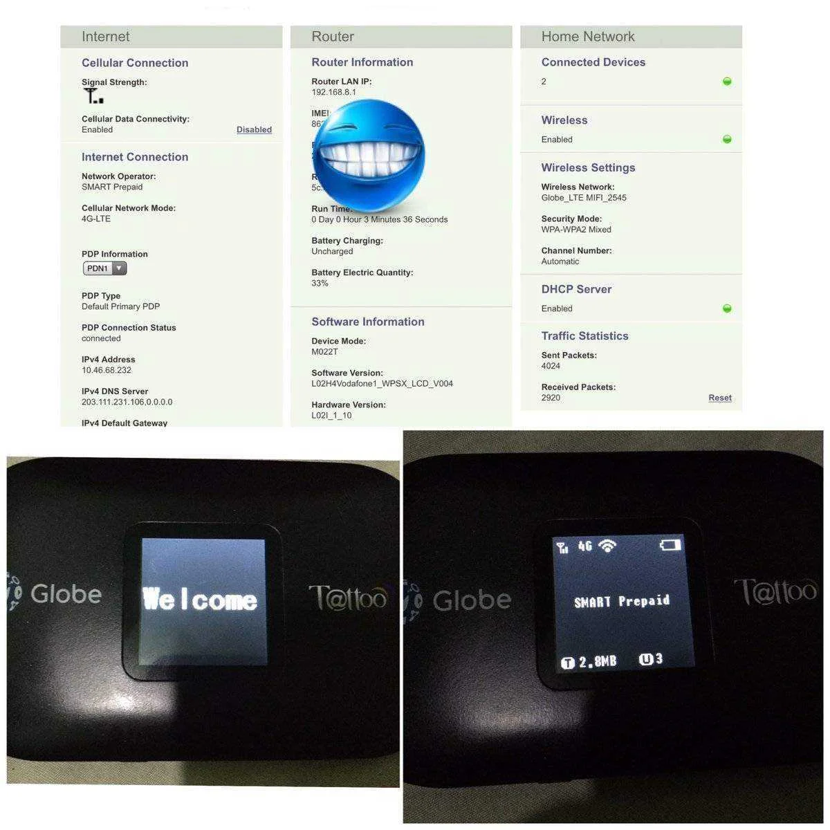

Features:
LCD is now fixed (now showing in startup screen “Welcome” instead of the “BOLT” logo)
Openline Firmware

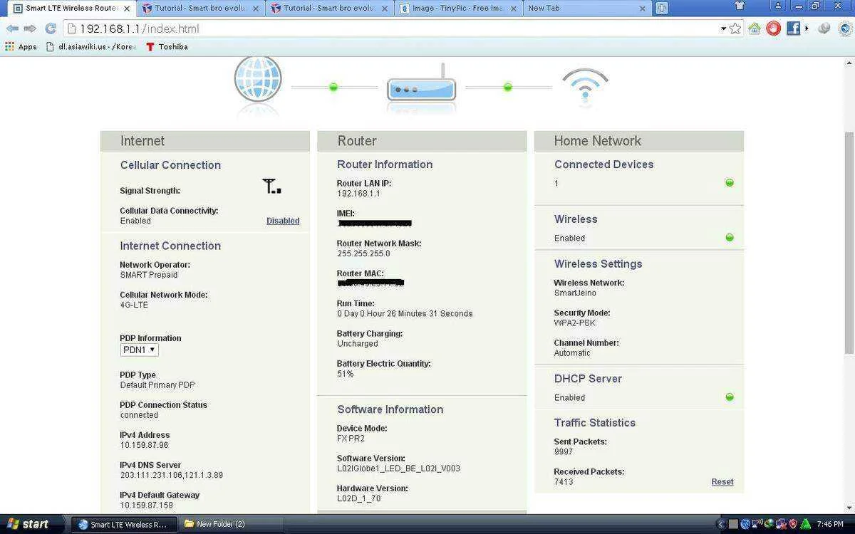

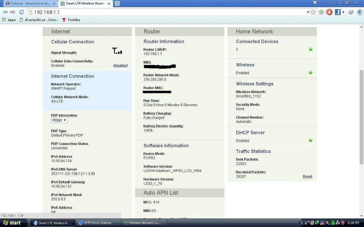

1: WPS is now RESET button (not good)- not fixed
2: SMARTBRO BRANDED using FXPR2 LCD firmware - because we are using smart webdata.bin to openline
3. Choppy signal (Will update pa) - try the new firmware uploaded
4. NO STOCK FIRMWARE (to revert back to globe) - stock firmware not yet available
5. Weird behavior It keeps vibrating for no reason at any interval - i didnt even know that our devices vibrate
6. Openlined (yes)
7. To access WebUI -- 192.168.1.1 not 8.1- because we are using smart webdata.bin to open line so no fix
8. If for some reasons, nakahide SSID nyo just press WPS (now reset button) then search "Smartbro" as new SSID - plug the pocket wifi to a laptop, access the the 192.168.1.1 from there and change the wireless settings.

Boss baka may stock firmware ka ng pang M022T. Humina kasi signal ng pocket wifi ko ng inopenline ko siya. Yung dating full bar na 4g naging 1 bar nalang tapos choppy pa.
