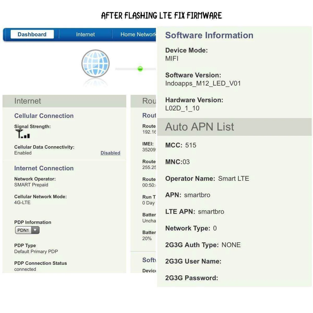

There are numerous feedback that LTE signal cannot be detected or getting lesser LTE signal bar after flashing earlier firmwares. I personally experienced that from 2 LTE signal bar inside my room to 0 after flashing the openline firmware.
I have L02H hardware version and as per argotrons instruction his firmware is ported to L02D and L02E so I was thinking that might be the reason but I am wrong it is not related to board version but to the firmware itself. Wheteher you have L02H, L02B, L02C after flashing hardware version in web ui will appear as L02D.

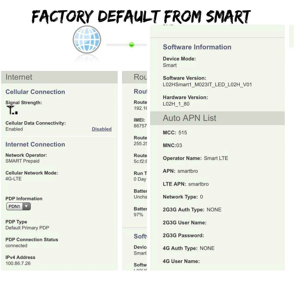

Next thing I did was to flashed totoymola's stock firmware for smart and sun network and LTE signal went back to 2 signal bar. (Strongly suggests that LTE signal issue is firmware related)
Then I just think that there can be a possible fix to LTE signal issues while maintaining openline status by trying to mix and match each files inside SWD folder of the 2 firmwares mentioned.
After an overnight work of mix matching I finally openline my FX PR2 without LTE signal issue :) :)
Screenshot of proof provided, I just missed taking a screenshot of 0 signal bar

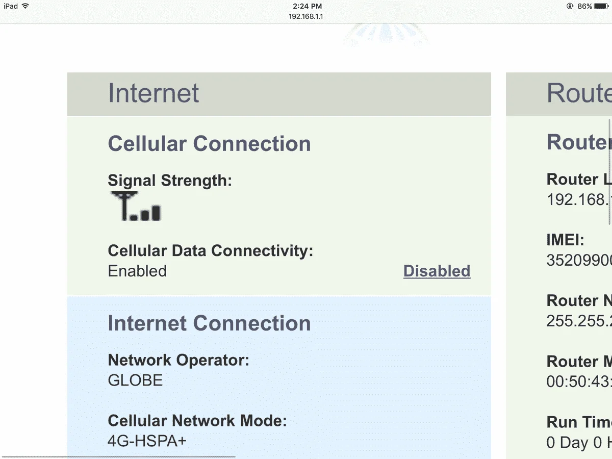

Red LED on signal indicator after inserting Globe sim card (if 4G HSPA+ or 3G signal detected) but doesn't affect performance. Yellow signal if LTE signal
UPDATE: Maayos ang red signal kapag naka LTE only lang sa globe at may masagap na signal (back to yellow LED light sa signal indicator). Therefore hinde buggy ang firmware na modify ko proof nandito sa pic.
Kapag naka 4g hspa+ or 3g duon nag re red light ang signal light sa globe. Globe LTE signal detected back to yellow yan.

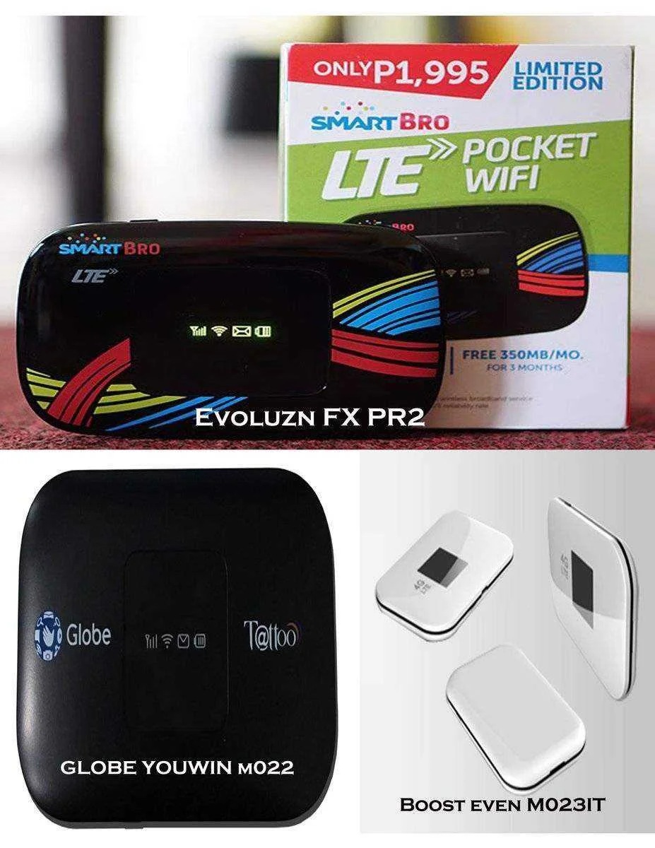

Tested it with MO23J. Not possible. Can someone port the same to MO23J? Thank you..
Because the firmware provided here is for LED type not for LCD Display type like FX PR2L and Youwin M023J.
There is a possible fix to M023J by cross matching FX PR2L stock firmware and FX PR2L openline firmware but I don't have the initiative to do that since I don't own FX PR2L or M023J to test things out.
