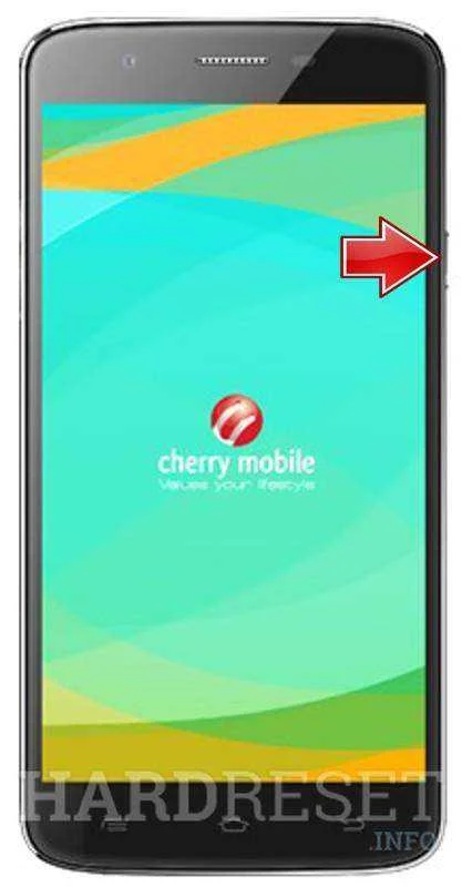

First method:

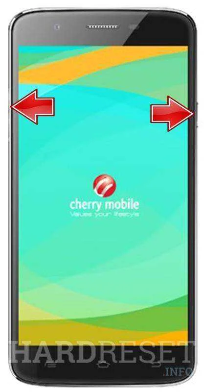

  1. The cell phone must be turned off so hold down the Power rocker for a short while.cherry-mobile-flare-4.webp
  2. After that press and hold the Volume Up + Power button simultaneously for about 10 seconds.cherry-mobile-flare-4.webp

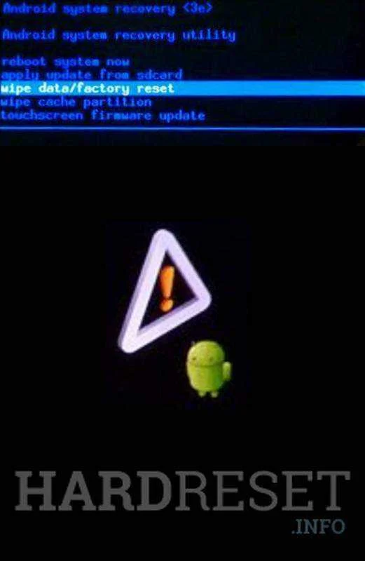

  3. When an Android Image displays on the screen press the Power button to enter Recovery Mode.cherry-mobile-flare-4.webp
  4. In order to choose "wipe data/factory reset" use the Volume Down to navigate and the Power button to confirm.cherry-mobile-flare-4.webp
  5. Then select "Yes--delete all user data". Use Volume Down button to scroll and Power key to select.
  6. To restart the phone, select "reboot system now".cherry-mobile-flare-4.webp
  7. Success! Your phone should begin the hard reset operation.
