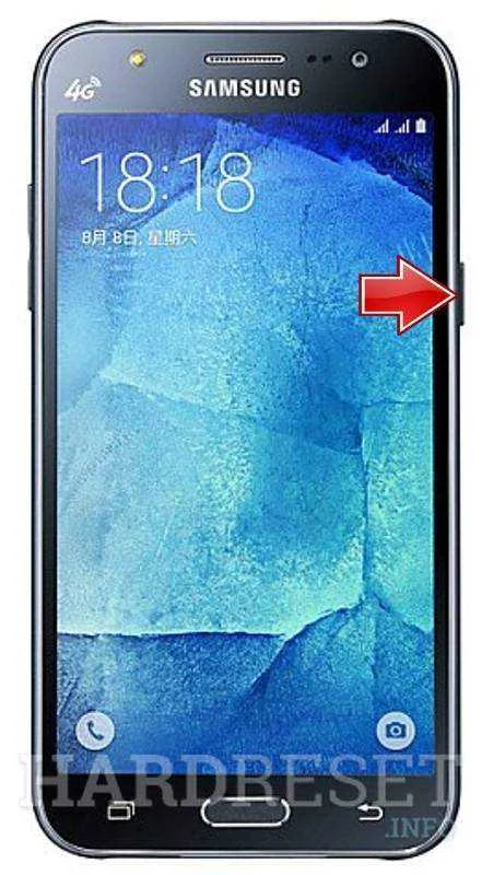

  1. At first switch off the cell phone by holding down the Power key for a short while.samsung-j700f-galaxy-j7.webp

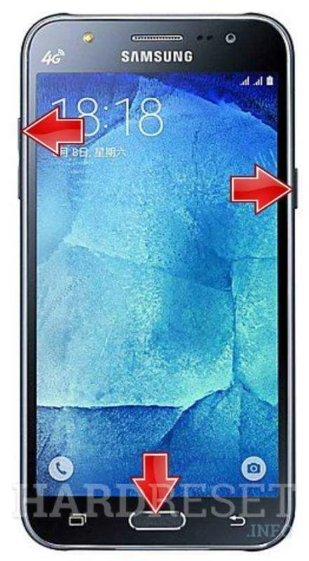

  2. Now press and hold together: Volume Up + Home + Power button for a couple of seconds.samsung-j700f-galaxy-j7.webp
  3. You should relese held keys when the Samsung Logo appears on the screen.

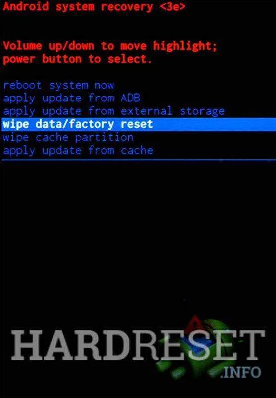

  4. Then select from Recovery Mode menu "wipe data / factory reset" using Volume buttons to navigate and Home key to confirm.samsung-j700f-galaxy-j7.webp

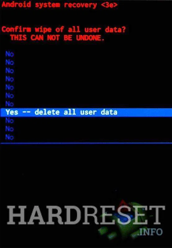

  5. In the next step choose "Yes -- delete all user data" to confirm the whole operation.samsung-j700f-galaxy-j7.webp

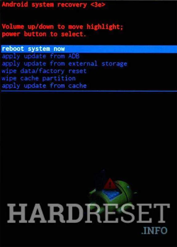

  7. Well done! The hard reset has just been performed.

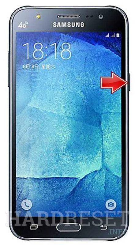

  1. Start by turninng on the device by using the Power key.samsung-j700f-galaxy-j7.webp
