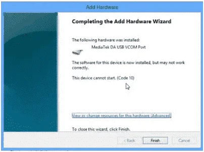

Install VCOM Drivers:
  1. Open mo ang Device manager sa My computer. Click on any item & Go to Actions > Add legacy hardware.
  2. tapos, Press next & select Install drivers manually.
  3. Press next ulit & click on Have disk.
  4. Sa browse option, select mo ang VCOM drivers as per your OS.
  5. Once its done. may makikita kang screen similar to this:
Once you are done sa Installation part, go to device manager & you'll find a device parang ganto:

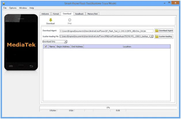

2. tapos Launch SP Flash Tool as Administrator
SP Flash Tool

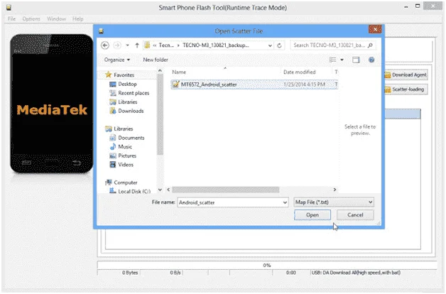

3. Click on Scatter-loading option & browse to the scatter file of your Stock ROM. (You can find the scatter file with the original stock rom zip file)
SP Flash Tool Scatter file selection
This will load few names on your screen with a selected box.
4. Now, kung gusto mo iformat ang phone, Click Format at the top.

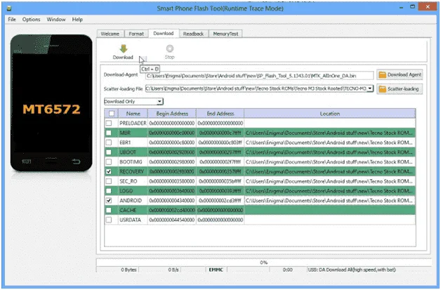

5. Once you are done with everything, click mo download button sa top ng window
Start flashing
6. Stop should now be prominent while other options should be grayed out

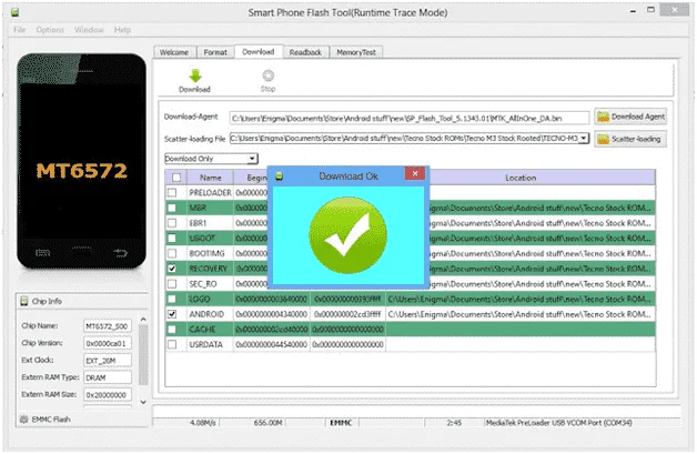

7. tapos Connect mo ang switched off phone (with battery inside) sa PC via USB cord
8. A progress bar should start running
9. Disconnect mo ang phone, tanggalin ang battery for 15 seconds (kung removable ang battery), tapos balik mo ulit sa battery then power up the phone.
