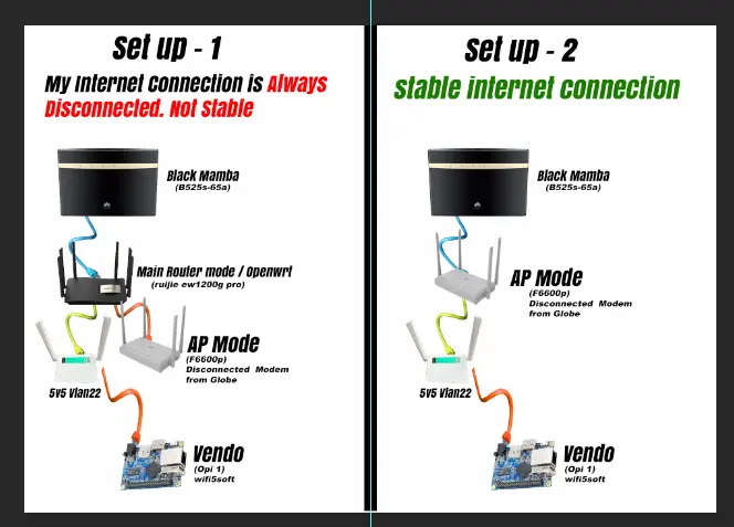

Baka meron naka alam or maka fix sa ganitong problema ko. :)
Balak ko kasi gawin is yung Setup 1. Para magamit ko yung Main Router. para ma manage ko
Kaso nga lang hindi stable yung net pag merong Main Router.
check if you have more than one DHCP server running. like with the Mamba and Main OpenWRT routers. parang na-mention mo sa kabila na hindi naka-bridge 'yung mamba.
Yes sir hindi ko na bridge yung mamba. Dpat po ba e Bridge Mode cya?
not necessarily, unless you have a more capable router to use as your gateway. having OpenWRT does open up some features.
ang kailangan talaga ay isa lang ang gateway na nagpe-perform ng NAT (network address translation) from your internal IP range to your public IP address. sure, pwede naman mag-doble, pero unncessary complication na ito.
obvioulsy, gumagana naman 'yung Option 2 para sa'yo. do you need any feature/functionality from OpenWRT? if you do, mas maganda kung naka-bridge si Mamba. kung hindi naman, magdodouble-NAT ka (Mamba + OpenWRT). gagana naman rin 'yan.
do you have the option to bridge Mamba? let OpenWRT do the routing (local IP subnet <-> public IP).
kung hindi naka-bridge, at gusto mo i-try.
  • set OpenWRT WAN port to DHCP Client (auto) para maka-pickup ng IP address from Mamba
  • set OpenWRT DHCP Server to a different subnet from Mamba - kung 192.168.8.0/24 si Mamba, gawing 192.168.10.0/24 ang DHCP range ni OpenWRT sa LAN side
si OpenWRT ay makakakuha ng 192.168.8.x IP address kay Mamba, tapos 'yung naka kabit kay OpenWRT ay magkakaroon ng IP address na 192.168.10.x. ganito dapat ang IP address ng mga AP at iba pang client mo.
mabuti pa i-post mo ring 'yung config ng OpenWRT router...
looks like si Mamba lang ang DHCP server mo at 192.168.13.x. tama ba? connect Mamba LAN port to OpenWRT LAN port, and it should work. pero basically, di mo magagamit 'yung ibang OpenWRT features dun sa second router.
otherwise, kung Mamba LAN port to OpenWRT WAN port ang connection, try the double-NAT solution. enable DHCP server on OpenWRT, but choose a different range ('wag 192.168.13.x).

Yes sir need ko e Manage yung Internet. sa OpenWRT lang kasi ako mag manage via SQM. e2 lang Feature na need ko. at yung adblocker
and about sa Bridge mode from Mama. Yes , meron po option pwde ko po e enable/disable ang bridge mode.
im gonna try yung suggestion mo sir. ibahin ko yung DHCP server ng OpenWRT.

first/best option is to set Mamba to bridge, and give all the routing functions to OpenWRT.
kapag hindi na-bridge si Mamba, try the dual-NAT approach, noting na dapat magkaiba ang DHCP range nila (Mamba & OpenWRT) to avoid conflict.
been a while since i had OpenWRT... di ba nalilimit ang pwede mong gawin kapag connected via LAN port? in effect, parang AP mode na rin kasi ito. can you apply VLAN 22 to a port going to 5v5 for Vendo?
