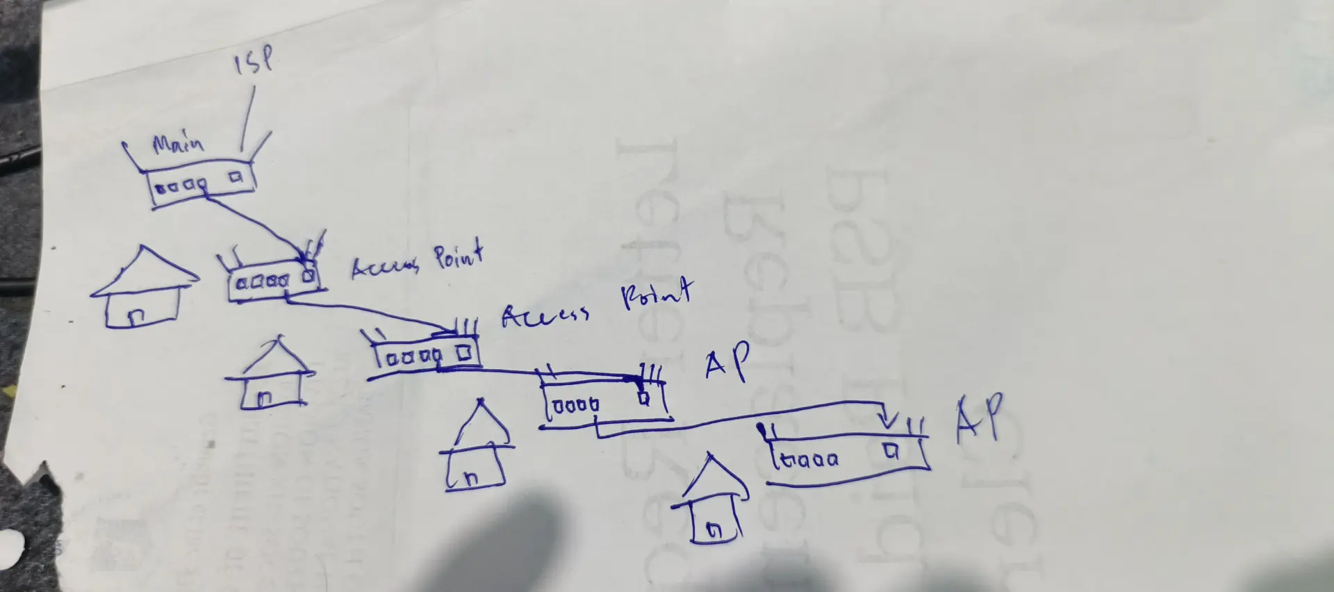

lagyan ko kasi router yung ibang room sa school para ma extend yung signal.. kasi may room na malalayo ... ang meron lang sa school is mga router lang .salamat mga master sa makasagot

Bakit need naka dhcp off? Pag ba AP, mas required na naka static zer?
Base sa sketch po, mag nested po ng routers , para maiwasan po rouge dhcp , loopback. Pag naka off po ang dhcp it will act as Switch and also di na mention anong brands ng routers nya . dapat pag AP naka Bridge po. It will depend na din po sa inyo and also magkakaron po ng multiple NAT pag sa WAN to Lan , technically pwede naman po sya but hindi lahat ng router supports bridging yun lang :)
as mentioned above, ensure that only the first router is serving IP addresses (DHCP enabled). 'yung iba, set to AP mode (some routers have this). kung wala naman, siguruhing nakapatay ang DHCP server. at taliwas sa diagram mo, 'wag gamitin ang WAN port ng ibang router.
pero seriously, wala bang budget ang school para sa isang enterprise-grade router, PoE switch at limang access point? pang-matagalang gamit naman ito.
there's some value to this. kung walang network management system ang lahat ng AP at nagre-rely ka sa web interface, it makes it easy kung alam mo IP address nila. either have it fixed, or if your main router allows you to reserve the IP addresses of the APs and other managed network elements. of course, alisin mo sa DHCP range 'yung mga reserved/fixed IP addresses.
