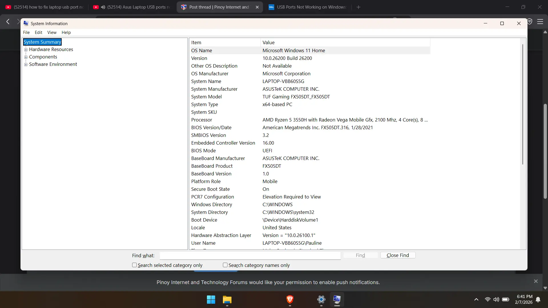

pahelp po mga master bigla na lang hindi gumana lahat ng usb port after daw iupdate ng kapatid ko etong laptop pero nagana naman ethernet port nya yung tatlong usb port lang ayaw, natry ko na iuninstall yung driver sa device manager pero walang nangyayare
go to internet, search asus (laptop model) drivers, select os type, win 11 architecture x32, x64
download usb driver
Common yan sa asus laptop, na overwrite yong asus drivers ng generic drivers after updates kaya ayaw gumana ng usb ports.
Uninstall generic drivers then install AMD Graphics, Chipset and HDMI Driver at ASUS System Control Interface
Pag ayas pa din, dahil mo nalanh siguro sa local tech.
