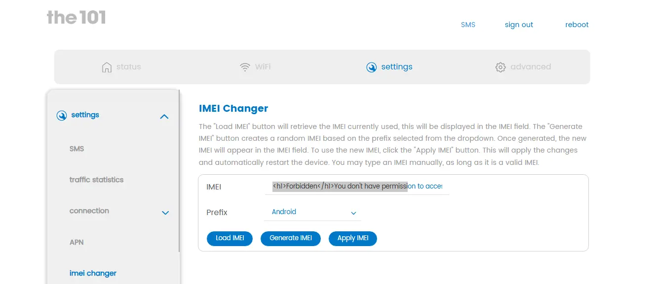

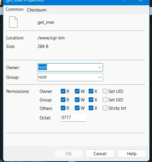

Boss trettet nagawa ko nmn eto pero pag pinundot na ung 'Apply IMEI' button, may error na nalabas:
tapos pag ung 'Load IMEI' button nmn, eto nalabas:
<h1>Forbidden</h1>You don't have permission to access /cgi-bin/get_imei on this server.
Pero nakaka-generate ng IMEI, working po ung 'Generate IMEI' button, pero pag inapply na doon na po ung error.

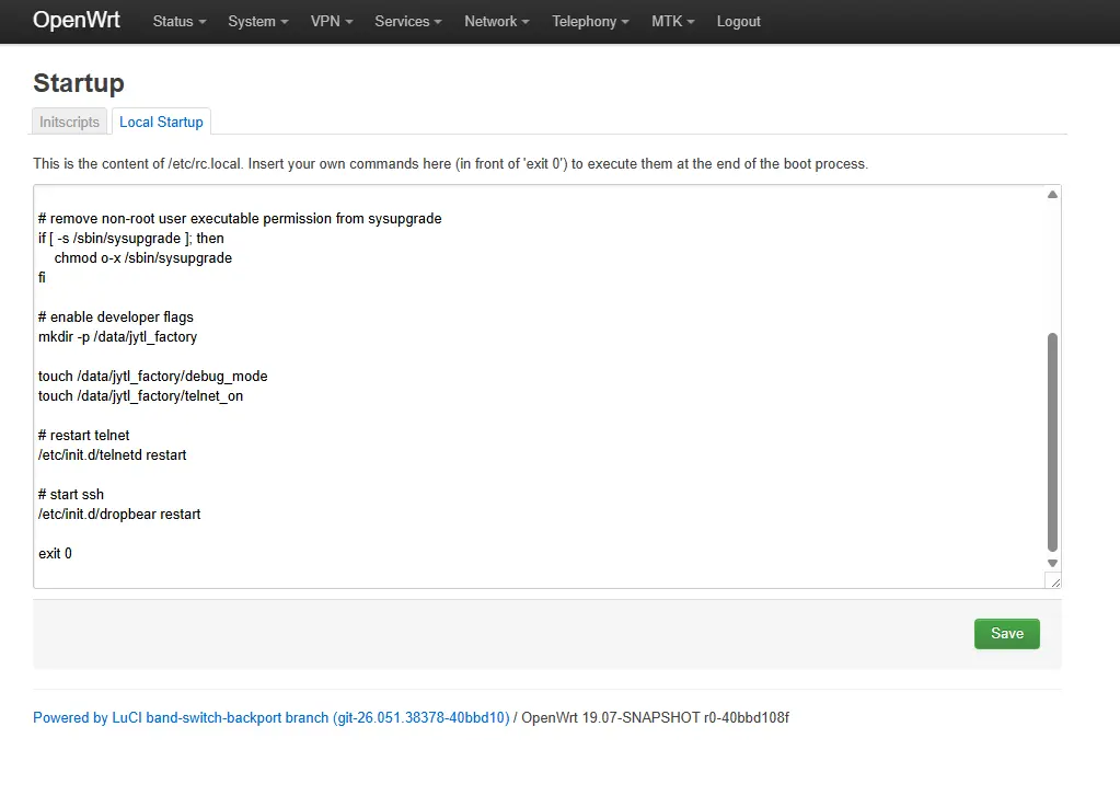

sa mga panay restart sa dropbear in startup add nyu ito this line para if mag reboot kayo ng modem naka always na open yung shh and telnet1779648965910.webp

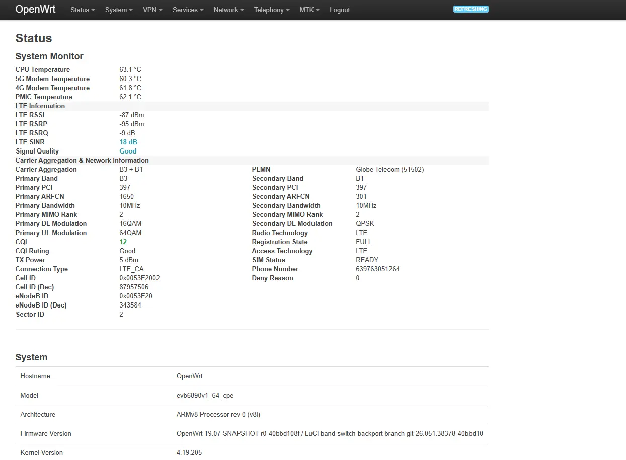

sa gusto ganito yung openwrt status see screenshots download nyu sa baba. tapos gamit kayo WinSCP

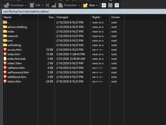

tapos lagay nyu dito yung file sa /usr/lib/lua/luci/view/admin_status na download nyu backup muna tapos paste nyu jan.
Download Link: You do not have permission to view the full content of this post. Log in or register now.

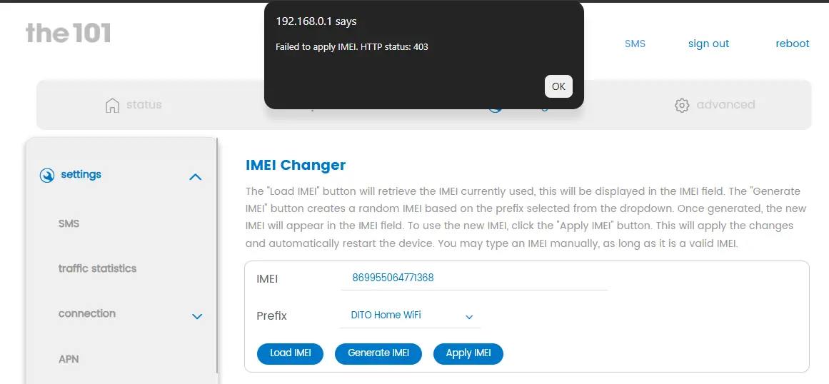

Thanks po...😇
Guys try nyo po update ng pers=missions ng lahat ng files sa loob ng "imei_changer_cyanide_v7" into this para gumana po sya.
paano yan mapalabas lods? ano pipindutin o may app na need? tnx
Windows laptop po pala gamit ko lods. tnx.
Update:
ok na lods, haha, napagana ko nga, change permission lang ginawa ko using ssh putty. thanks.
chmod 777 filename
