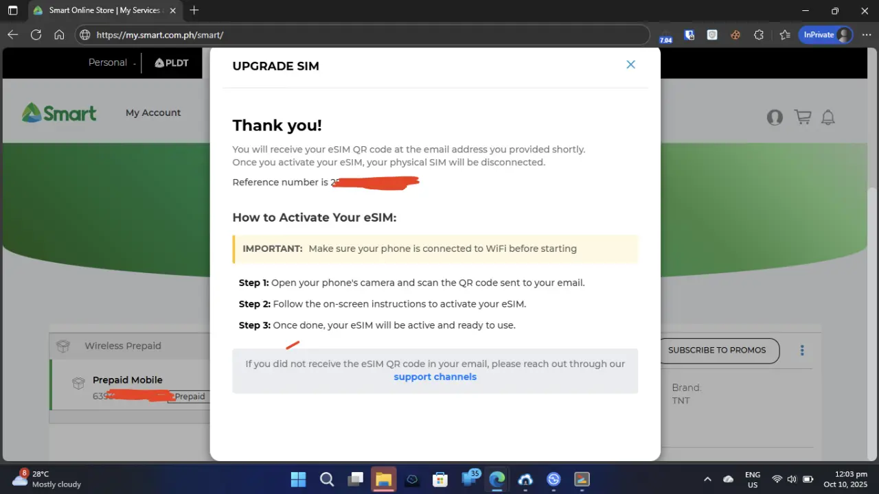

Sa mga gusto mag upgrade to esim ng existing physical sim nila while keeping the same number. Available na s'ya via mySmart online. Hindi na kaylangan pumunta pa sa Smart Stores na puro pag uupsell lang to Upgrade po postpaid ang alam.
Here's how:
1. Open You do not have permission to view the full content of this post. Log in or register now. and log in or create an account.
2. Tap on the ellipses (…) and choose Upgrade SIM.
3. Tap Send OTP.
4. Enter the OTP that you will receive and tap Verify.
5. Enter your email address and tap Verify Now.
6. Tap Send OTP to begin email validation.
7. Enter the OTP that you will receive via email and tap Verify.
8. Tap Submit to complete the Upgrade SIM request.
Note: Your current SIM will be deactivated once you receive your eSIM QR.
9. Wait for the confirmation screen and for the eSIM QR to arrive in your email.
Note: Make sure you have a stable WiFi connection during the eSIM activation.
10. Scan the QR that you will receive via email to install the eSIM.
That’s it! You’ve successfully upgraded your Smart Prepaid physical SIM to eSIM using MySmart.

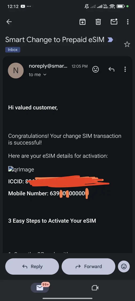

I just upgraded now my prepaid TNT sim mabilis lang ang process and free. Carried over din yung load at existing promo
Yun ohh. Same din sakin. Nag upgrade to eSIM pero sa Multi SIM nakalagay, physical sim pa din hahha. Para kasi kapag nag upgrade na ng device ay ready na, naka eSIM na 🥰
