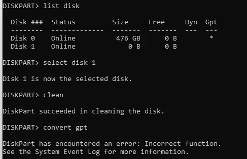

Hello po need ko po help regarding my external hard drive it seems corrupted
Ganyan lang po lumalabas sa PC ko at ayaw nya ma format any suggestions na maka fix nyan ?
Salamat in advance
kung
Not visible po sir mag not responding lang sya
mag not responding lang po sya then not visible
kung not responding, ang prob nyan ay mismong board na, kagaya yan saken, check mo yung temperature underneath ng HDD mo kung mainit habang attached sya sa unit mo, kung umiinit yun na po yun...
test mo sya sa Diskpart, clear mo yung volume at partition then format lods...
