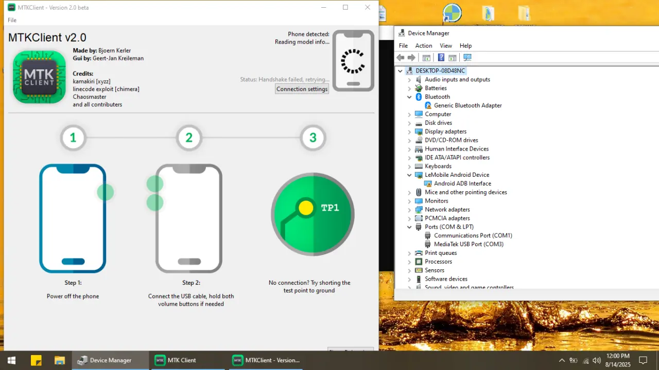

boss pa help ako na bypass kuna peru ganun parin ayaw ma detect. 1755144112021.webp
handshake failed nakalagay di na-bypass security di sya mag-proceed sa brom
detected nman sa device mngr(mediatek usb port)
pwedeng driver conflict or minsan nagupdate din security need ng bagong latest auth file
