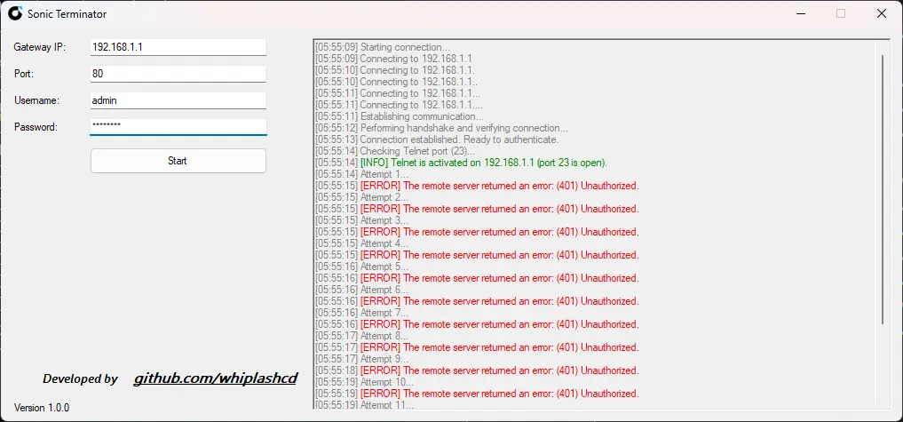

Share ko lang tong Gawa ko for ZTE F660/F670L baka makatulong po sainyo.
Download Nyo Lang Po Tong Program Eto Po Link
Kung Paano Po gamitin Yan Is
Kailangan po ay Naka Enter yung Valid username and password ng Admin Credential ng Modem at yung Valid Gateway IP Address Ni Modem Mostly (192.168.1.1)
sa Port naman ay naka Default lang Sya to 80
Kung Mali naman po yung username and password ng Admin Credential ng modem na na-enter ay Yung Program na po kusang mag A-attempt kung anong admin credential ng modem nyo
base po doon sa built in admin credential finder ng Program until na Mahuli na yung Valid Admin Credential Then ibibigay na ng Program yung User at Passwd ng Telnet nun ZTE F660/F670L Modem
SUPPORTED PO F660/F670L NG CONVERGE, PLDT AND SURF2SAWA BASTA VALID ADMIN CREDENTIAL PO ANG NAKALAGAY

once na gamit mo na yung tool
then telnet to your modem - On CMD telnet You do not have permission to view the full content of this post. Log in or register now.
use the login generated password and user na binigay nun tool then after login
type mo na sa terminal nun
setmac 2176 vendorid
setmac 2177 serial
after malagay mo na yung vendor id at yung serial
ireboot mo na yung modem
at yung sa serial number ganito format
S/N: ZTEG12ABCD576
Vendor Id = ZTEG
Serial = remaining characters
kopyahin mo lang ang vendor id at serial ng isang router na gusto mo kopyahin
then next step kopyahin mo VLAN settings doon kana sa admin panel after mo maset yung GPON S/N
