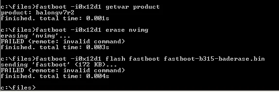

bakit puro failed pag fastboot nako sa erase nvimg at baderase.bin,,
ok naman response nang getvar product may response na balongv7r2
