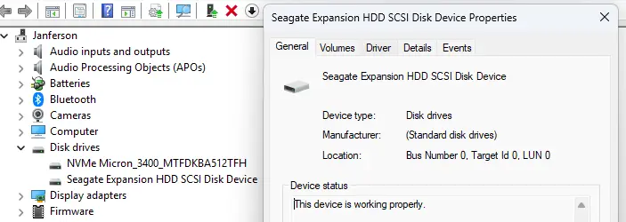

bigla nalang nag crash laptop ko then pag unplug ko umokay laptop ko then when i plug it in again narerad ng system na may plugged na external hard drive pero di sya nag aappear sa file explorer :(
wag mo muna galawin, baka naka unallocated yan. Try mo muna kung mari-read din ng mga recover softwares
di sya nareread boss. pero kapag nasa device manager dun sa diskdrives nag aappear sya pero wala naman sa file explorer :(

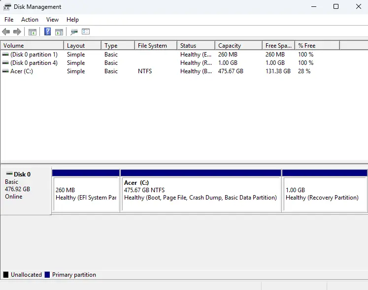

Ss mo sa disk drive, baka unallocated yan, need mo pa i-allocate yan para try mo kung marecover files mo.
di po sya nareread sa disk management

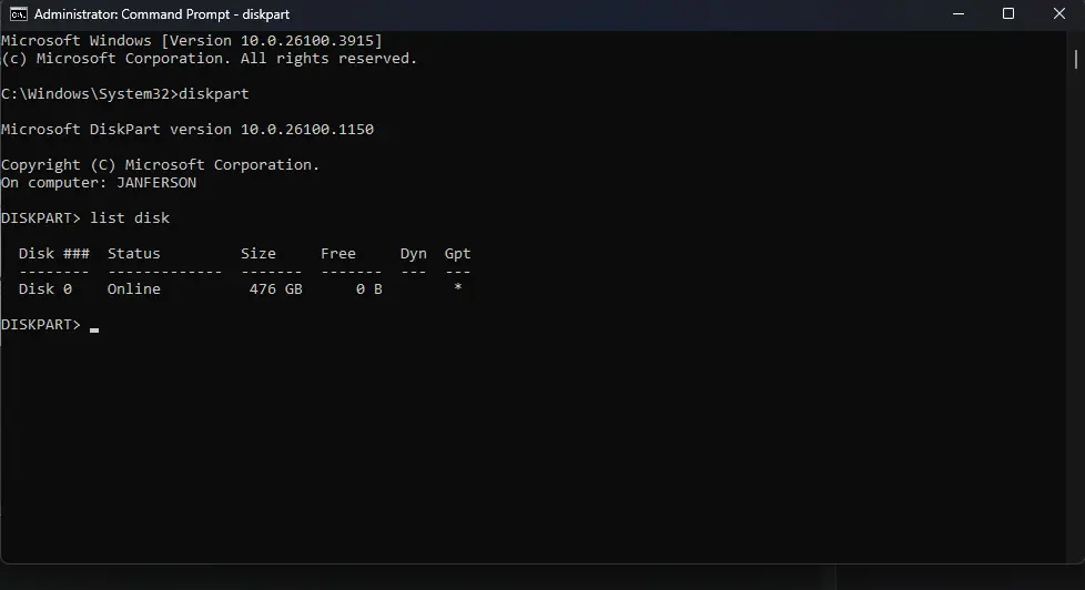

I see. Last questions po
1. Kumukuha po ba sa iba mong device yung drive?
2. If ma access and properties. Can you repair it there? Sa Tools section.
3. Open CMD run diskpart then list disk, see if nandoon yung disk (this is because diskpart can access lower level ng computer kaysa sa Disk Management).
wala po talaga :(
