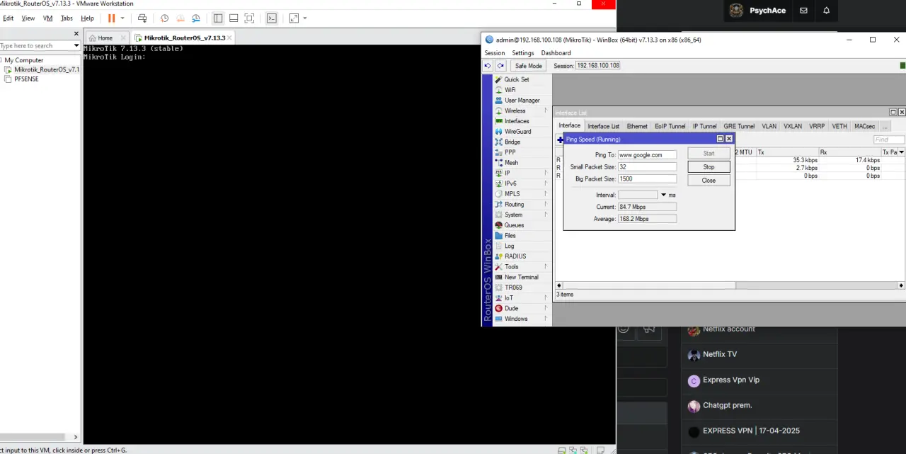

why does mikrotik using vmware only get about 150mbps net speed, when I have a gigabit connection?
VMs are a bit trickier to make sense of for people other than the admin. a bunch of other unknowns come into play:
  • hardware the VM is running on (any possible limitations?)
  • resources allocated to the VM
  • other VMs possibly demanding resources
also, Ping Speed is not a good indicator of bandwidth, as it approximates bandwidth based solely on ICMP. have you tried doing a speedtest from a connected device rather than the routeros vm itself?
another possibility is that you're testing to 'google.com', and the route to whichever google server you end up using could be a factor. can you try this with you RSP/ISP and see what difference you get, if any?
i've never used Ping Speed ever, and on trying it now i'm getting the 'Couldn't start - not allowed by device mode' error. i'll play with this when i find time.

Yes, I tried it using PPPOE router without limitation, the consume bandwidth is around 200mbps. I also thought that vmware is the reason why I can't utilize all the available bandwidth of my internet.
I won't risk it implementing to my server that may affect my clients net speed, currently I have 10 household plus EAP connected to gigabit switch. I'm trying to figure out this mikrotik so that I can automate my billing to my customers xD

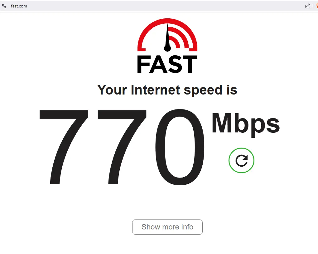

not pfsense tho, curious lang ako why vmware MT can't use this bandwidth but nonetheless wala namang issue sa mga clients.
current speedtest from fast.com 11:35pm
