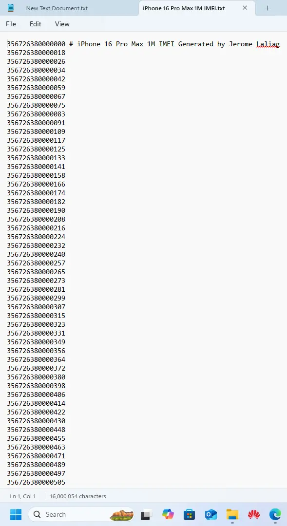

Eto mga working lists na IMEI based on iPhone 16 Pro Max:
Download Link: You do not have permission to view the full content of this post. Log in or register now.

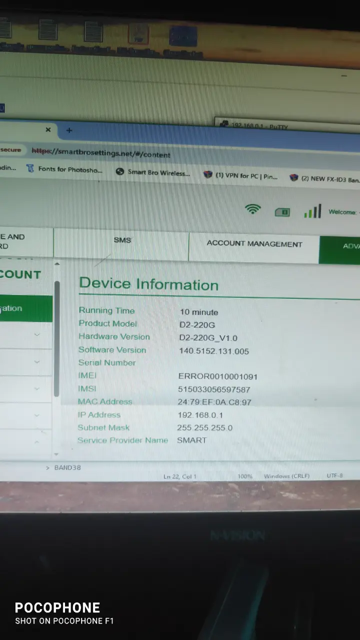

Boss yung greenpacket d2 ko nag change ako imei di ko na machange nag error na after ko madelete
Error na nakalagay 😭
