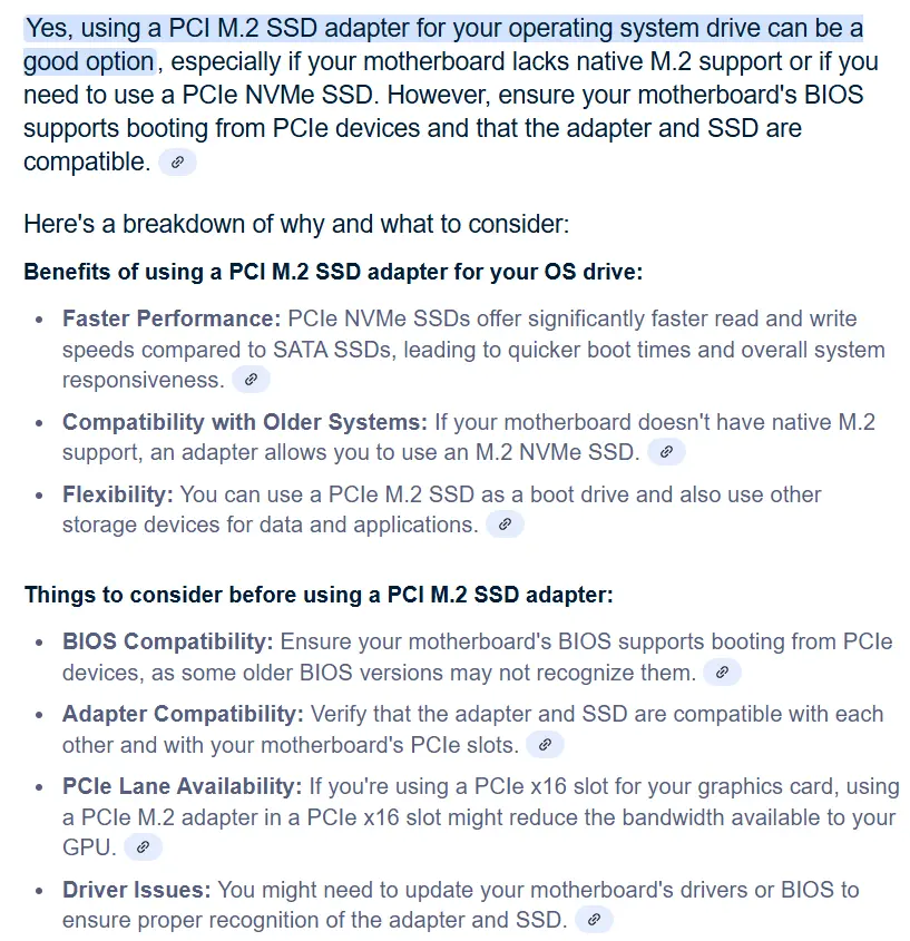

ok lang vah to gamiten sa computer ko wala kasing slot pang ssd m.2?
