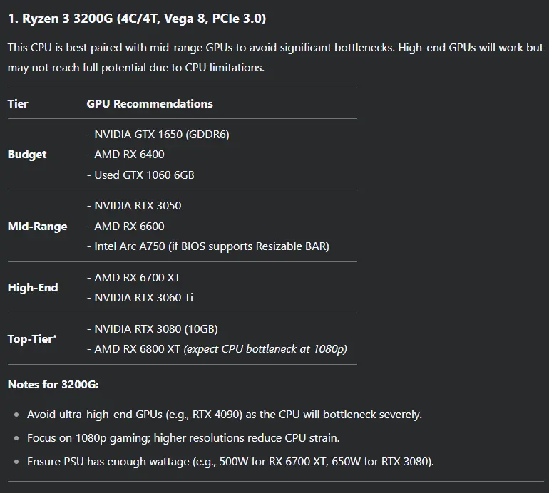

1st unit is ryzen 3 3200g ano list ng GPU na pwede dito from cheap to top

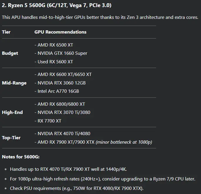

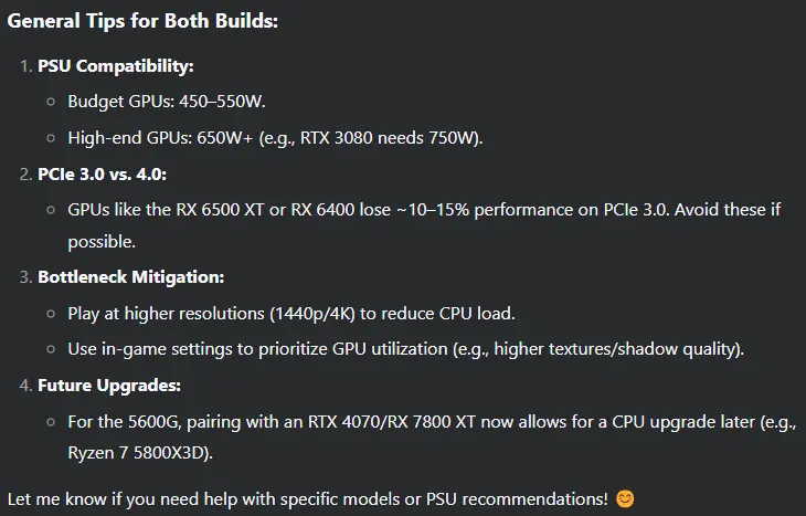

2nd unit ryzen 5 5600g anong list ng GPU from cheap to top salamat po. Natanong ko lang baka pasok sa budget ko sa april para ma ready ko :)
Ryzen 3 3200G can barely handle RX 580. but still better than using 1050ti and cheaper i guess? so no other option there..
Ryzen 5 5600G at best RX 6600XT above that is already bottleneck..
Now this is based on 1080p monitor.. kung nka 1440p ka. then your first PC can now handle rx 580 still thats the limit. of course pde kang bumili ng mas malakas kung gusto mo mag sayang ng pera..
the 2nd PC though. you can get up to RX 6800XT in 1440p.

Current ko po is ryzen 3 3200g with 1440x900 monitor po.. gsto ko sana mag lagay gpu for dual monitor para maka petiks ako mag laro while working
1st pc pili ka
1060/ti RX580 RX5500
cheapest yung RX580 good value yung 5500 if makukuha mo sya less than 7k
1060 legend for a reason really good card kaso medyo mahal even on the 2nd hand market like any nvidia card
