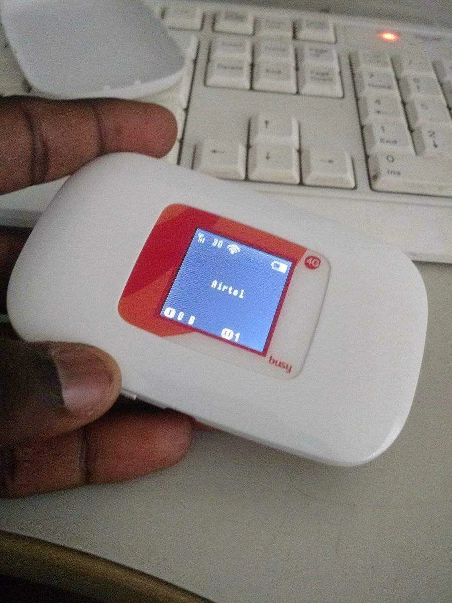

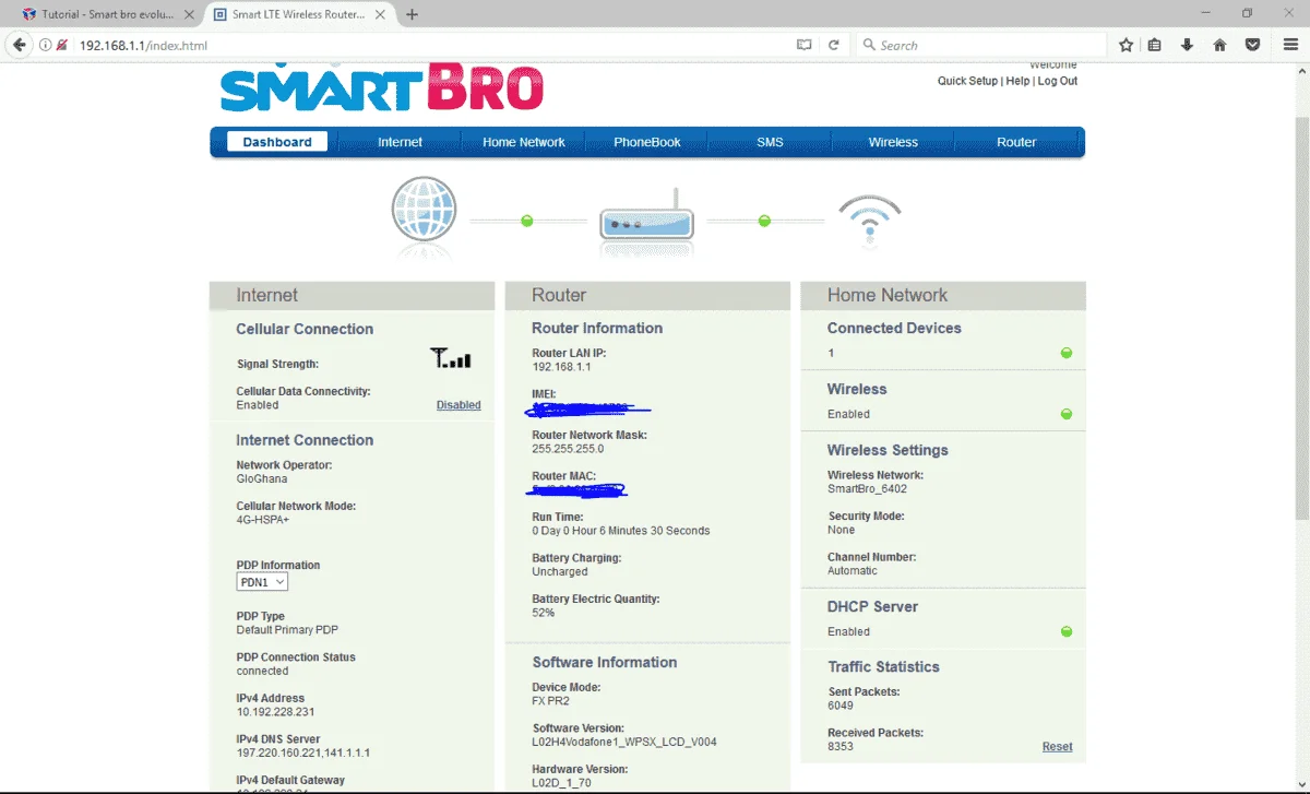

I just finished flashing it. Thaaaaaannnnkkksssssss. It finally worked. I have working signal here in Ghana. zedicus Check this out. usher105 i think you should create a thread with this firmware for the M028T. Once again thanks.
Would you mind inserting different sim other than your current network, and if it ask for PIN enter 123456... and feedback if the code will work I ported that maybe 2-3 weeks or about a month ago for M028T but I stopped since I cannot test it on my own because I don't have M028T only. MO23IT and M022T.
With credits to reliabledata creator argotron
It doesn't require any pin.. I just tested airtel and it works fine..

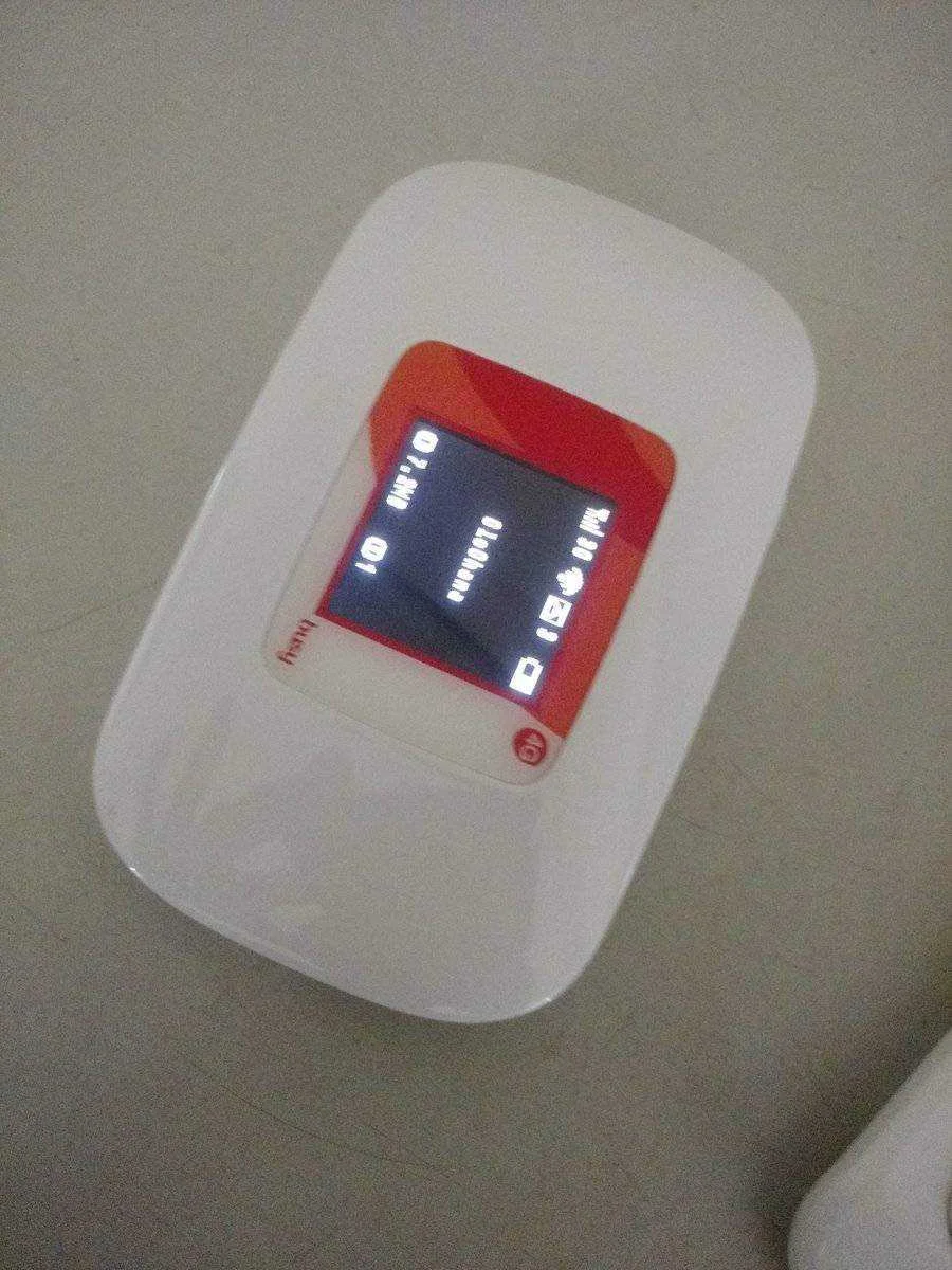

It's not the same svlleyy(FBF_versionNotMatch Error) mine iformations are :
Software_Version
L02CCameroon1_M023_LCD_V005 Oct 13 2016
Hardware Version
L02C_1_30
Device Model:
M028T
FX_PR2L_FNL_VER
can you send me a datafile or zippyshare link of that firmware? I cannot remember the file names that I used and zippyshare link for I have a lot of SWD files in my PC due to mix matching of firmware file :):)
That's the link kamputs: You do not have permission to view the full content of this post. Log in or register now.
