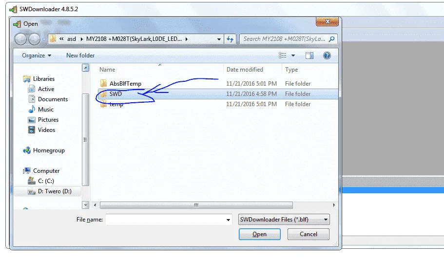

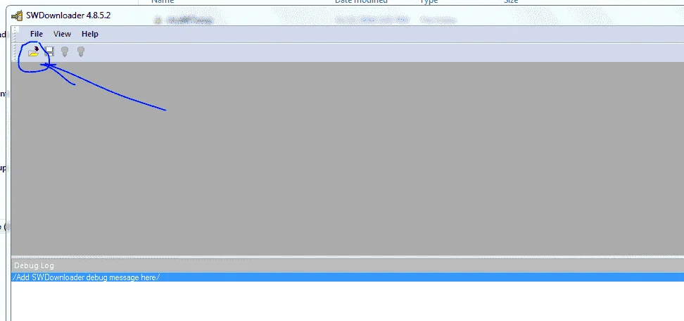

then extract anywhere and open SWDownloader.exe file
Second Step

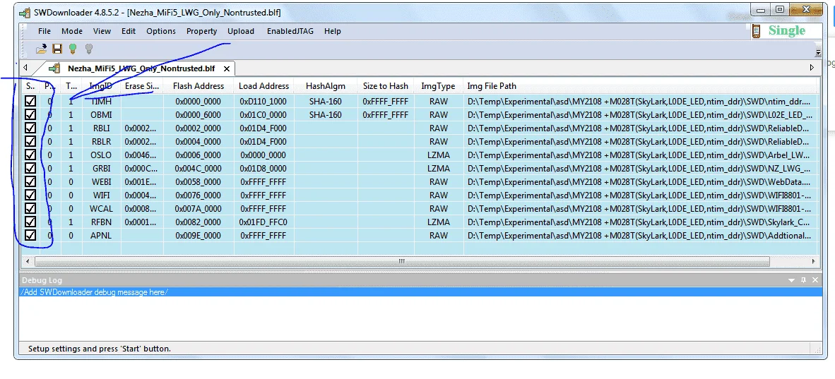

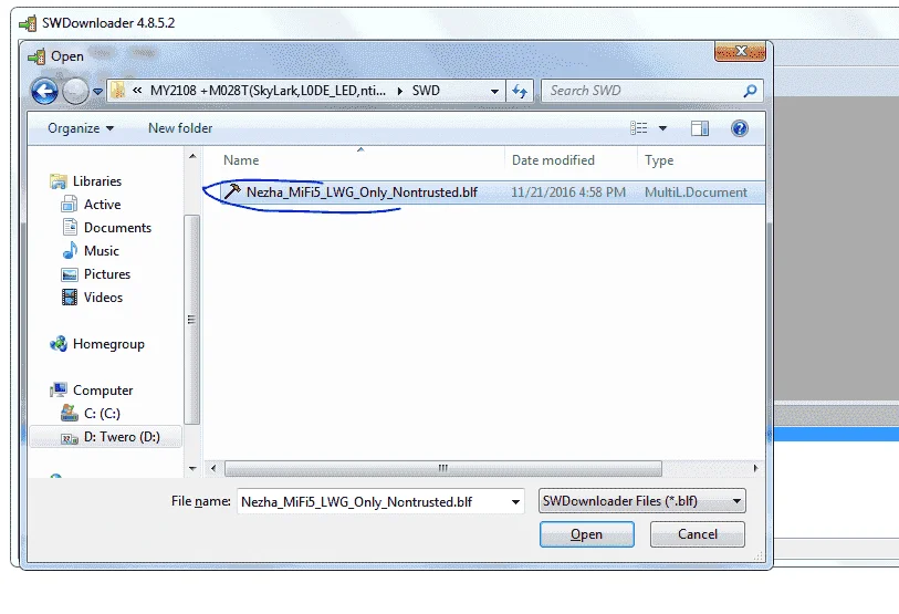

Open the .blf file
Check all
then Click green bulb
After clicking the green bulb the red bulb must light up.
