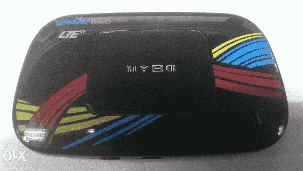

upload_2016-11-21_22-58-28.webp upload_2016-11-23_4-49-36.webp OPENLINE FOR FXPR2 Evoluzn SmartBro LTE pocket wifi

Expected State after doing this tutorial
Openlined(I've only tested it on Globe sim)
Signal Icon on the divice will always be RED even if its working properly.
troubling in connecting 3G network
The SSId And Password sometimes resets(ill check this, wait for update)

FXPR2 and M023J is just a firmware
the name of this hardware/device is
L02D
and also FXPR2 is a M023 firmware
both of them is for L02D device/hardware
so the answer of you question is
they are different but both are for the same hardware
so if you do this tutorial
it will still work
but i havent yet tested it
