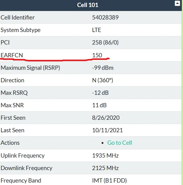

kapag madami tower sainyo, mas maganda talaga naka cell id locking para hindi lumilipat
Oo, malakas upload kapag 0 4 at 7 10 yung combination, pero mas gusto ko yung 0 1 mas stable sa download
