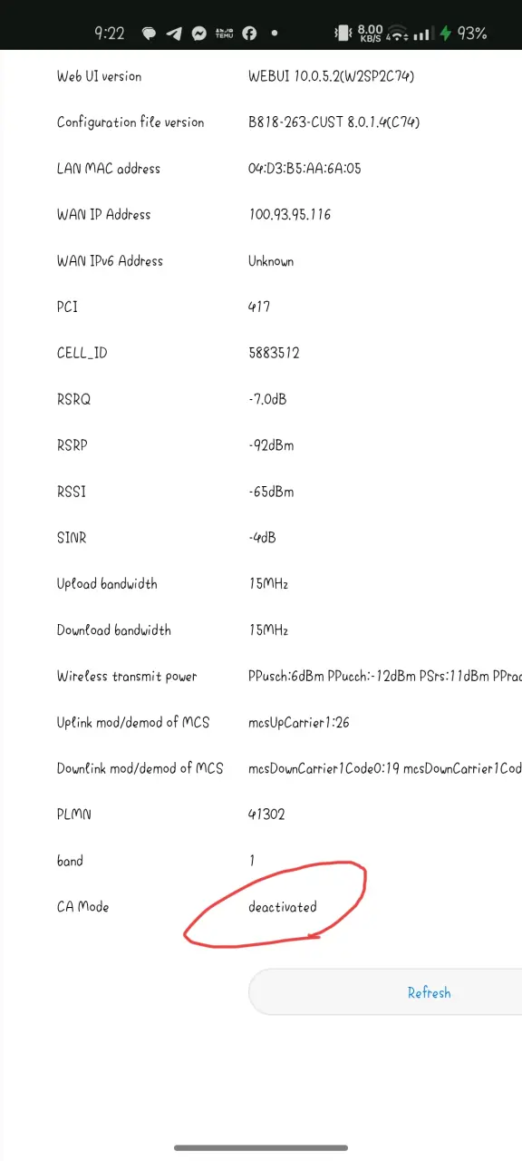

Sino po meron B818-263 na nka optus firmware dito, ask ko lang kung ano ginawa nyo dahil ayaw nya mg CA at nka capped lang sa 20mbps speed nya.
Ganito rin nangyari sakin, nung una umaabot siya ng 100 mbps (optus firmware) then after mag maintenance ung tower deactivated na CA capped na din sa 20 mbps.
Pa help namn mga lods
I think meron problema sa firmware meron ako vodafone at huawei firmware na b818 okay nmn performance yung sa optus lang tlaga meron problema. yun nga lang di pwd palitan ng firmware ang b818.
I have the same issue with my B818-263 optus firmware. I have good signal with B1 and B3 but CA not working. I have manually locked those bands but still same issue. Is there any way to fix this. Or can we flash huawei firmware to this router?
this is true. pwedeng i-disable ito ng carrier. and they do this, especially kung di kaya ng backhaul from the tower.
