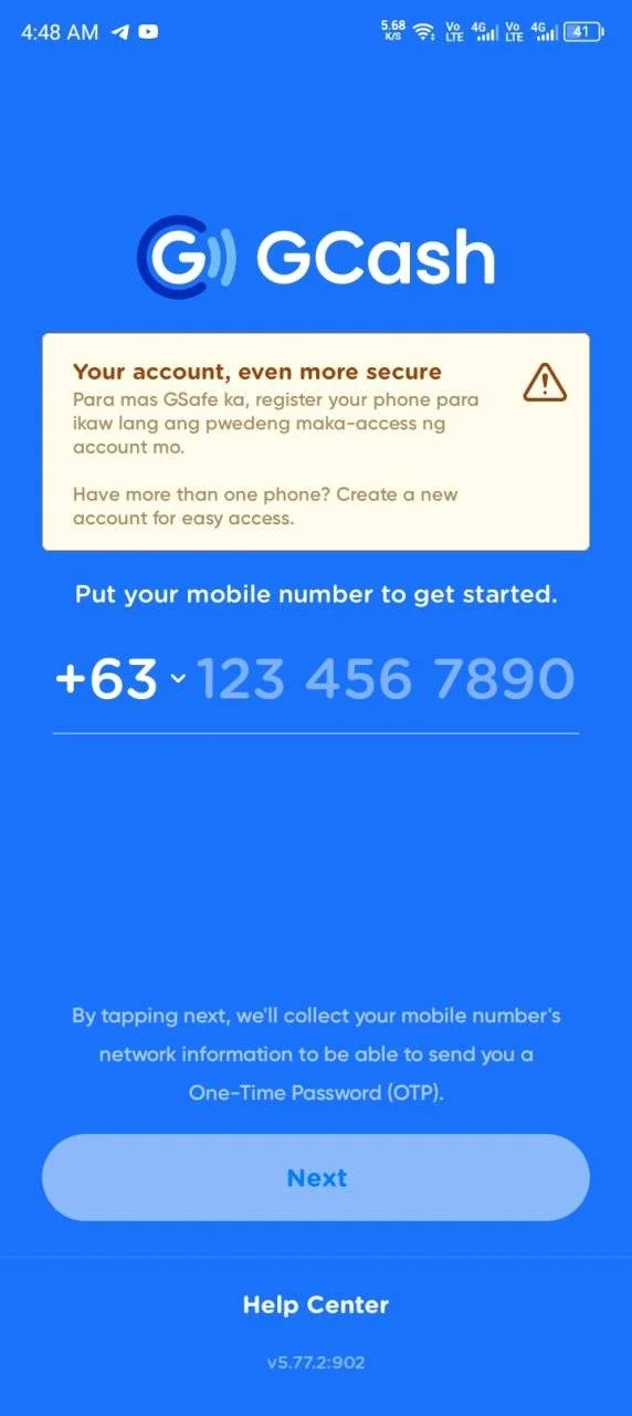

๐Ÿ‘จโ€๐Ÿซ Tutorial Itel P55 5G root using KitsuneMask to avoid banking Apps detection like Gcash

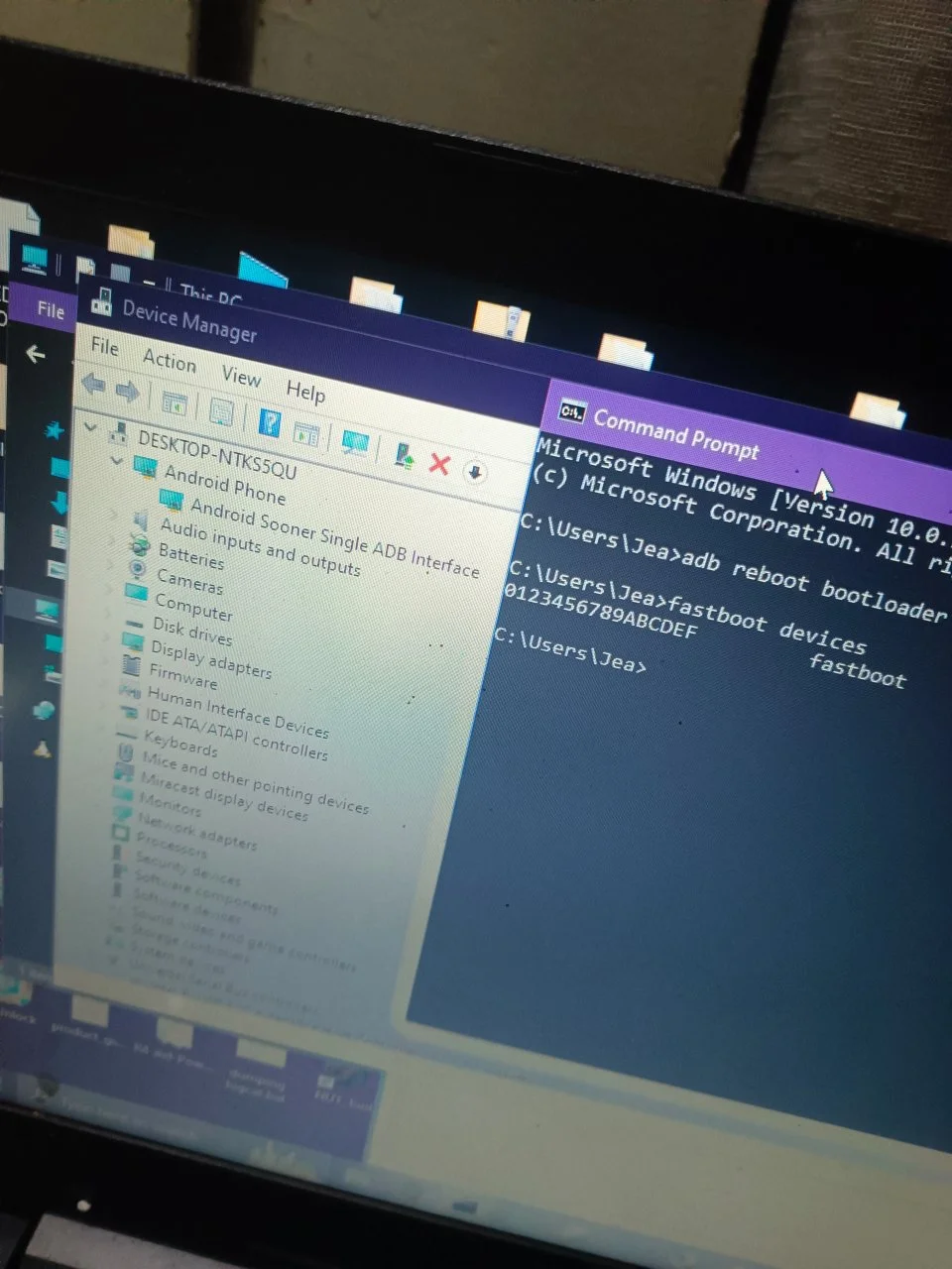

Punta sa "Device Manager" tignan mo if naka install ng maayos yung bootloader drivers..
9. punta sa CMD at e type and "fastboot flashing unlock" tignan ang phone merong logs nagsasabing volume up or down. PAKIBASA na lang hahaha..

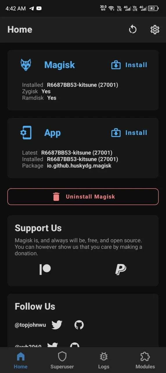

10. type "fastboot flash boot magisk_patched-27001_TUiGv.img" (BOOT.img na patched ng KitsuneMask)
11. type " fastboot flash vbmeta vbmeta.img --disable-verity --disable-verification"
12. type "fastboot reboot recovery"
13. sa recovery e wipe ang data para sure na mag boot yung system.
14. e install mo yung app provided dito sa thread
15. open kitsunemask > settings > turn on Zygisk, Magiskhide at Enforce SuList
16. reboot
17. para mag grant ng SU permission.. Open KitsuneMask > Settings > Configure SuList. tapos check mo yung app na gusto mo ma detect ng Root permission.
Pwede patingin kung anong itsura ng tamang bootloader driver? Di ko maunlock bootloader ko baka sa driver nagkakatalo. Triny ko na halos lahat ng method ng pag unlock ng bootloader bukod sa ฯรกรญd.
