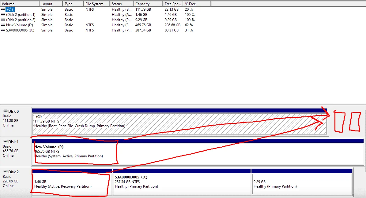

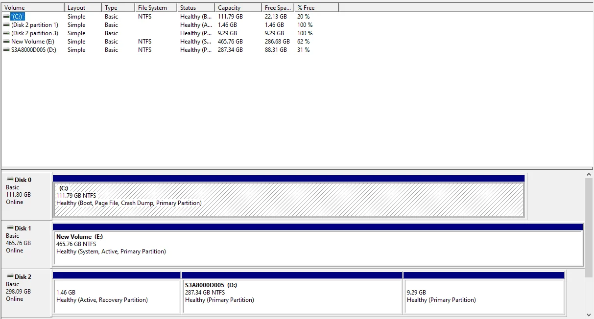

somehow yung master boot drive mo andun sa D. at wala sa C. just to confirm my theory. can you post the disk management? and check which drive is the system active?
hiwa hiwalay yung mga partition mo.. ang system mo nasa E. ang recovery nasa D. sa isang drive lng dapat yan. kaya cguro ayaw mag boot ksi may nwawala pag tinanggal mo.

yung d po is from my old laptop drive so disregard po yan i just added it cause i was getting some files from it nandyan kasi yung boot at recovery nung laptop hehe. just for clarification.
yung d po is from old laptop drive so disregard po yan i just added it cause i was getting some files from it
even if hindi natin e sali ang D since gagana naman ang PC kahit walang recovery partition. nasa E yung system partition mo. no system = no boot. E yung tinatangal mo dba?

thats the problem. since nasa E yung system. di tlaga mag boot PC mo pag wala yun. need yun sa OS.
option mo is either to format t completely pinaka easy and simple. or hassle way is to clone the system back to C.
