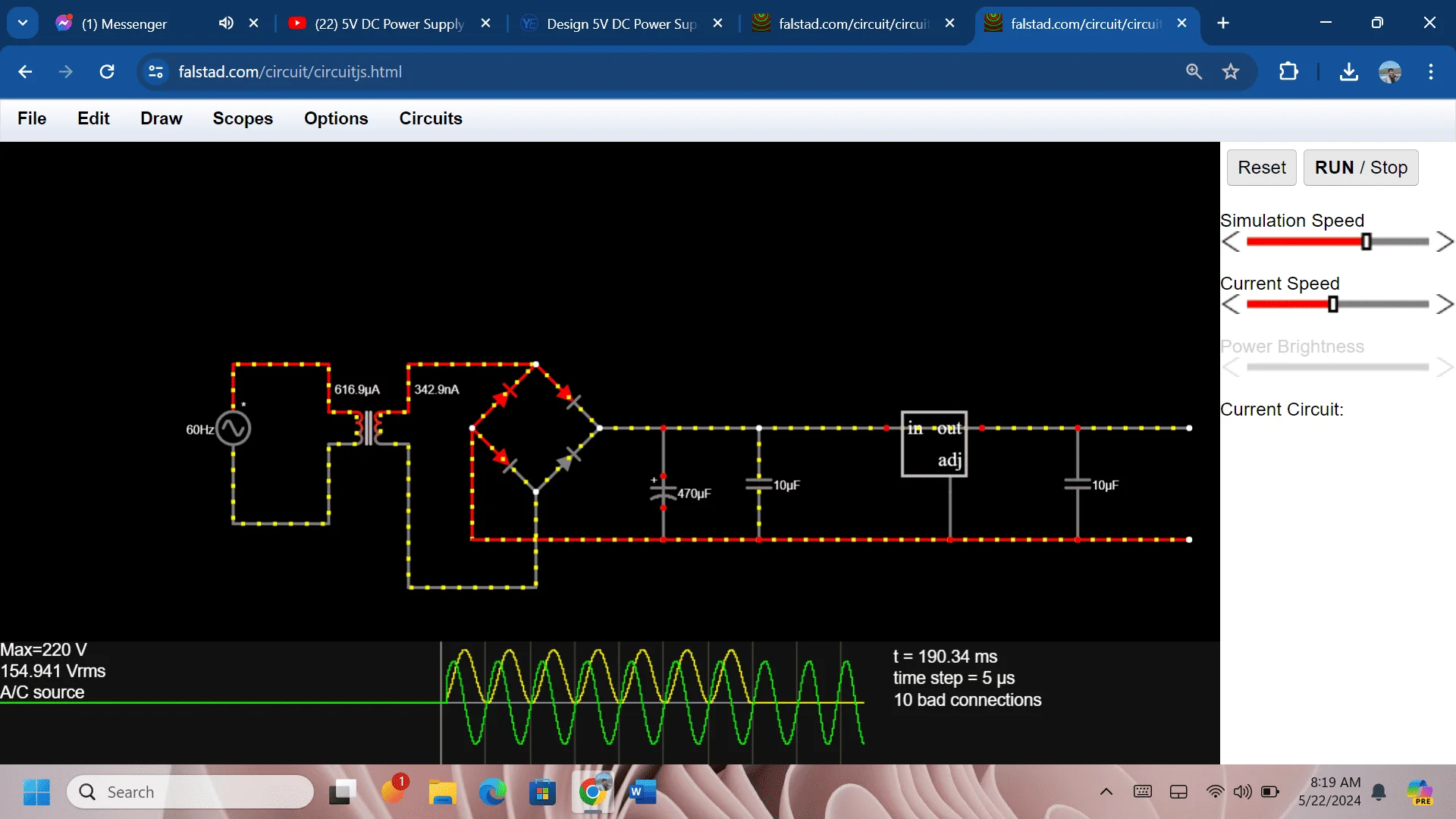

Pa help naman po sa marunong dyan kasi po may project po kami for finals
Electronics 1 po yung subject then may problem po ako para sa project namin kasi major din namin to and ang hirap ng mga ka grupo ko..
Need ko lang po maayos yung circuit board namin para po ma convert into 5 voltage 😭
Hello! I can help you with your project on converting a circuit board to output 5 volts. To do this, you will need a voltage regulator IC such as the LM7805. Here's a simple guide on how to do it:
1. Gather the Components:
- LM7805 Voltage Regulator IC
- Capacitors (typically a 0.33uF and a 0.1uF capacitor)
- Resistors (if needed for specific applications)
- Breadboard or PCB for circuit assembly
- Power source
2. Circuit Connection:
- Connect the input pin (Vin) of the LM7805 to your power source (usually a higher voltage source).
- Connect the ground pin (GND) of the LM7805 to the ground of your power source.
- Connect the output pin (Vout) of the LM7805 to your circuit. This will output a stable 5 volts.
3. Decoupling Capacitors:
- Place a 0.33uF capacitor between the input (Vin) and ground (GND) pins of the LM7805.
- Place a 0.1uF capacitor between the output (Vout) and ground (GND) pins of the LM7805.
4. Testing:
- Once you have assembled the circuit on a breadboard or PCB, connect the power source and measure the output voltage using a multimeter. It should read close to 5V.
5. Additional Considerations:
- Make sure to check the datasheet of the LM7805 for the specific wiring diagram and additional information.
- Ensure that your input voltage does not exceed the maximum input voltage rating of the LM7805.
If you encounter any specific issues or have more detailed requirements for your project, feel free to ask for further assistance. Good luck with your project!
