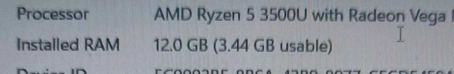

C ClockStrike Eternal Poster May 14, 2024 #1 Tanong ko lang po kung ano solution sa ganto. Nag-upgrade ako 8gb ram binabasa naman pero pag tinitignan sa task manager hindi sya nagagamit. Salamat po
C czept Eternal Poster May 18, 2024 #22 Marami lang yan, punasan mo yung mga pin ng bulak na may alcoh0l, linisan mo din yung mga slot Upvote 0 Downvote
L LITERALLY NO ONE Grasshopper May 19, 2024 #23 from my experience, try resetting the bios or load optimized defaults in bios before you boot. Upvote 0 Downvote
A AdmiralKape Elite May 20, 2024 #25 kung 32 bit ang laptop mo dapat gawin mong 64 bit yung pag install ng os limited lang ang 32 bit kaya di nya na gagamit yung ram Madin08 said: kung 32 bit ang laptop mo dapat gawin mong 64 bit yung pag install ng os limited lang ang 32 bit kaya di nya na gagamit yung ram Click to expand... yung ram pareho lang ba sa old ram mo? Upvote 0 Downvote
Y Your Fellow PHC Peace Out! ^_~V Contributor May 20, 2024 #27 install 64bit OS ClockStrike Upvote 0 Downvote
A atSanghan May 21, 2024 #29 Baka yung RAM may problema kasi pwede rin magkaroon ng temporary fix Upvote 0 Downvote
T taurexn Eternal Poster May 22, 2024 #30 its your motherboard, hanapin mo sa bios yun feature na memory remap and set to disable Upvote 0 Downvote
