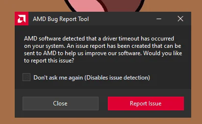

Nag try na ko ng Gigabyte Rx 6600 eagle nag tatime-out ang driver, nasearch ko din na eto common issue nito.

any brand ng RX 6600. kpag nag install ka ng driver make sure its GPU driver alone hindi kasali ang Adrenalin software. 1660 super vs rx 6600 is not even a competition. rtx 2070 ang katapat ng rx 6600.
colorful is a good brand mapa nvidia or amd
sa choice na binigay mo best pick is yung rx6600
pero if dota2 lang naman habol mo no need for extra power since esport title sya
so gtx 1660 is kayang kaya na pero yan is if strict dota 2 lang
as for driver error my solution yan if yung problema is driver lang talaga
uninstall mo yung radeon software or tangalin mo yung driver mo using ddu
tapos install ka ng driver through windows update
ang problema yan din yung error nalalabas pag yun gpu is my dead vram channel
pag ito yung problema well either pa reflow mo sa my marunong or bili ka ng bago
