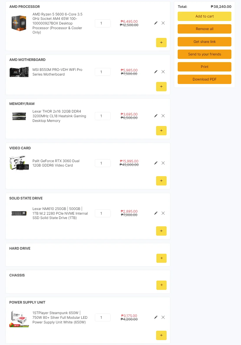

CPU - Get Ryzen 5600 instead of 5500 its way better overall
Board - is good, but try to check the MSI B550M Pro VDH WIFI if its cheaper get it instead ( Got mine for 5.2k using mega discount)
RAM - If hindi maxiado importante ang hitsura sayo. better get Lexar Thor 32GB 3200mhz CL16. almost same price lang dyan sa T-Force Dark (got mine for 2.7k using mega discount)
SSD - If you can find a cheaper PCI-e 4.0 much better to make full use of the B550 and 5600
GPU - check other brands if you can find cheaper one. (Palit is only around 16k)
PSU - Better get 650W or 700W FSP or Silverstone is a bit cheaper. (550W is enough but better think of future upgrade instead of just your build today unless gusto mo ulit bumili ng PSU pag nag upgrade...
PSU - Better get 650W or 700W FSP or Silverstone is a bit cheaper. (550W is enough but better think of future upgrade instead of just your build today unless gusto mo ulit bumili ng PSU pag nag upgrade kana)
Case - doesnt really matter its a personal choice as long as everything fits inside.

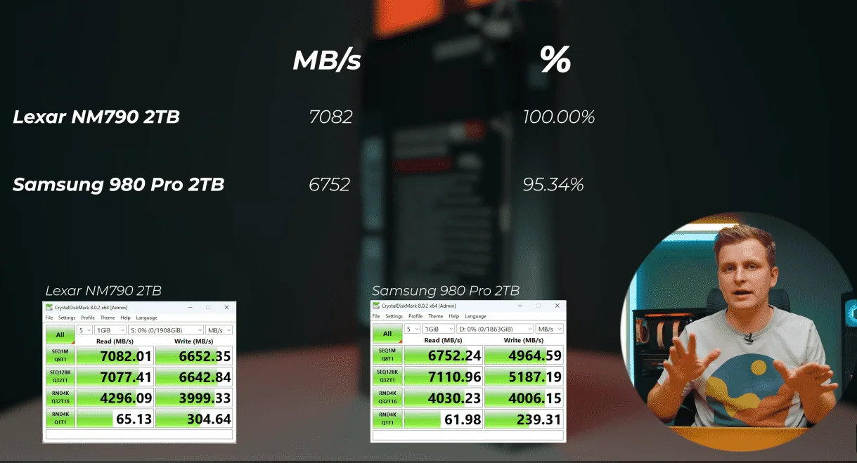

SSD: Tier list pick din hot hot
best budget NVME cant go wrong with this
This is just for reference. Bermor Price
Sige master check ko yang mga suggestions mo. Yung GPU nakita ko yang Palit brand mura nga po hindi ko lang kasi sure pa kung reliable brand.

Opo nakita ko dyan. May comment lang kasi sa shop na dapat compatible sa motherboard yata na gen4 para magamit full potential ng ssd, para sure ko lang na pwede sa board ko. Mabibili na din kasi ng 3.1k with mega discount
lahat ng B550 board supported ang Gen 4 SSD, ( Except dun sa 2 Slot boards. mga cheap B550)
