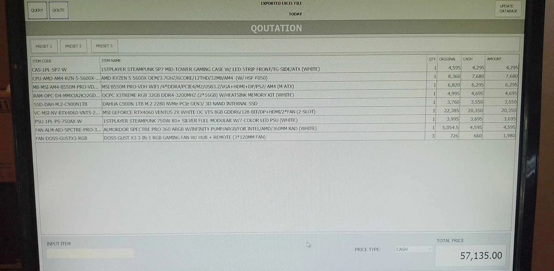

ok ba yung gpu ? or give me na mas mabilis na gpu under 20k

meh, not worth it ang ryzen 5 5600x sa price, mas cheaper ang ryzen 5600 at the same performance lng ng X version.
price to performance wise, hindi logical mag AIO ng 360mm tapos ryzen 5 lng CPU mo that is a lot of waste money, unless gusto mo lng ng physical aestethics.
you can get a 2.5k price of a good air cooler which is on par or better than many 240mm AIO.
then you can add the extra to your CPU to get a ryzen 7 5700x or add in the mobo and get MSI MAG.
MSI "PRO" version = cheap version and bad for OC.
MSI "MAG" version = better in OC.
lastly, you will get a B550 board. which is already Pcie Gen4. the SSD on your list is only Gen 3. get a gen 4.
if money is no problem then its ok
pero if gusto mo maka mura
change cpu to 5600
since wala syang pinag kaiba sa X version performance wise
yung cpu cooler na yan i dont trust
di porket aio and 360mm eh maganda na
pagdating sa aio naka dipende sa chamber manufacturing yung performance
example yung 200mm aio ng YGT is hindi pa kayang talunin stock cooler ng amd always go for good brand for aio or get an air cooler
yung psu na yan avoid at all cost
isa lang ang good psu ng 1st player and yun yung steampunk 80+ gold lahat ng psu nila na hindi yung 80+ gold eh notorious na almost generic lang construction and performance
