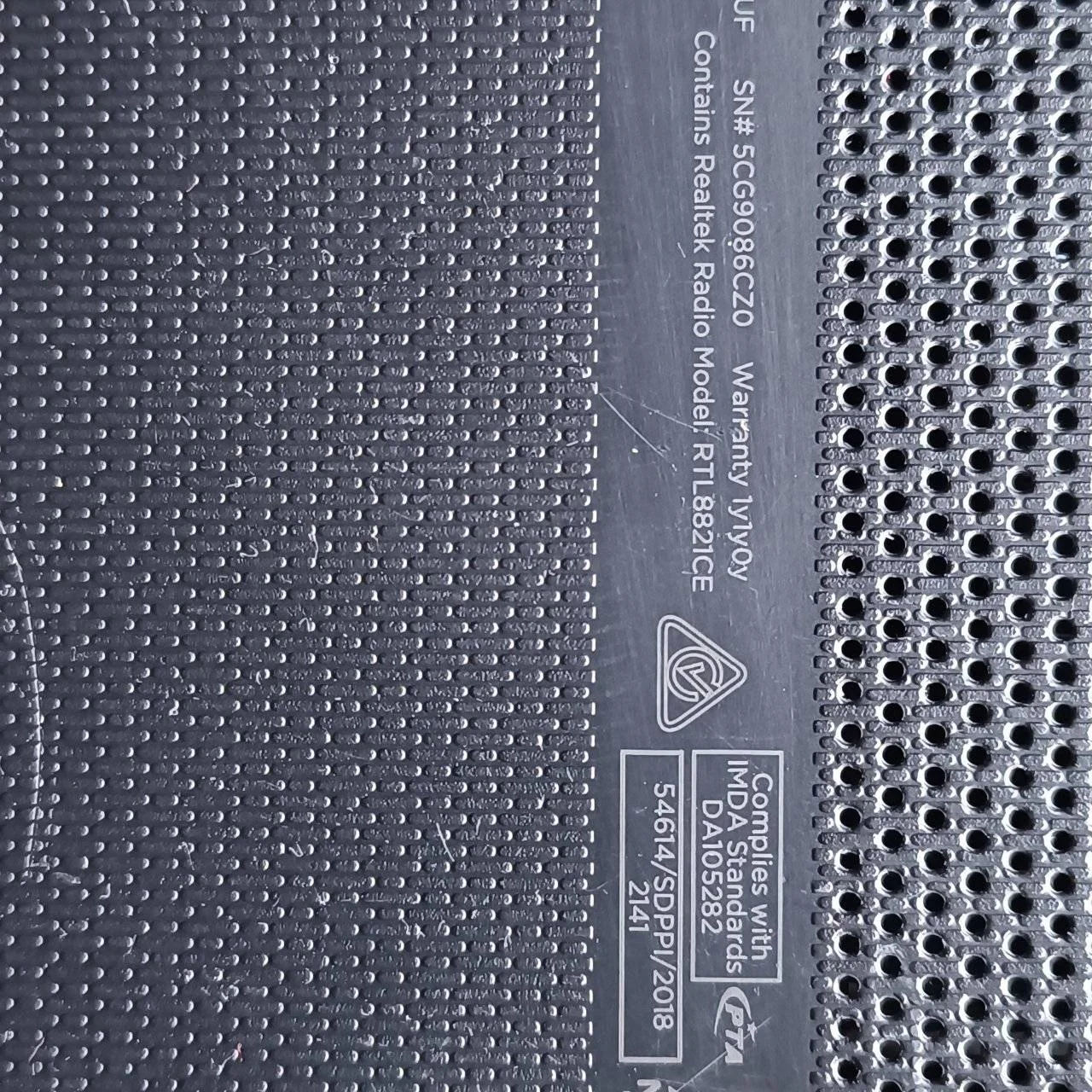

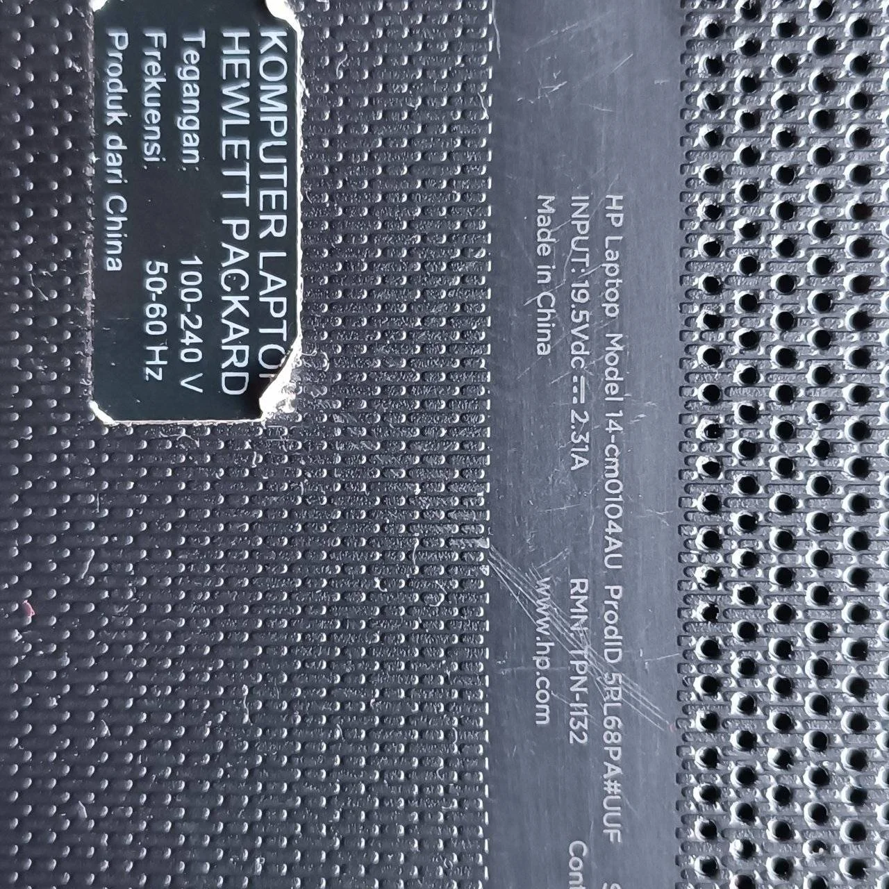

ang PN nya is 5RL68PA
website link: You do not have permission to view the full content of this post. Log in or register now.
lodi pde mag ask sa serial # pra ma double check natin?
nway so far ang sabi ng kakilala ko is max 16GB RAM
