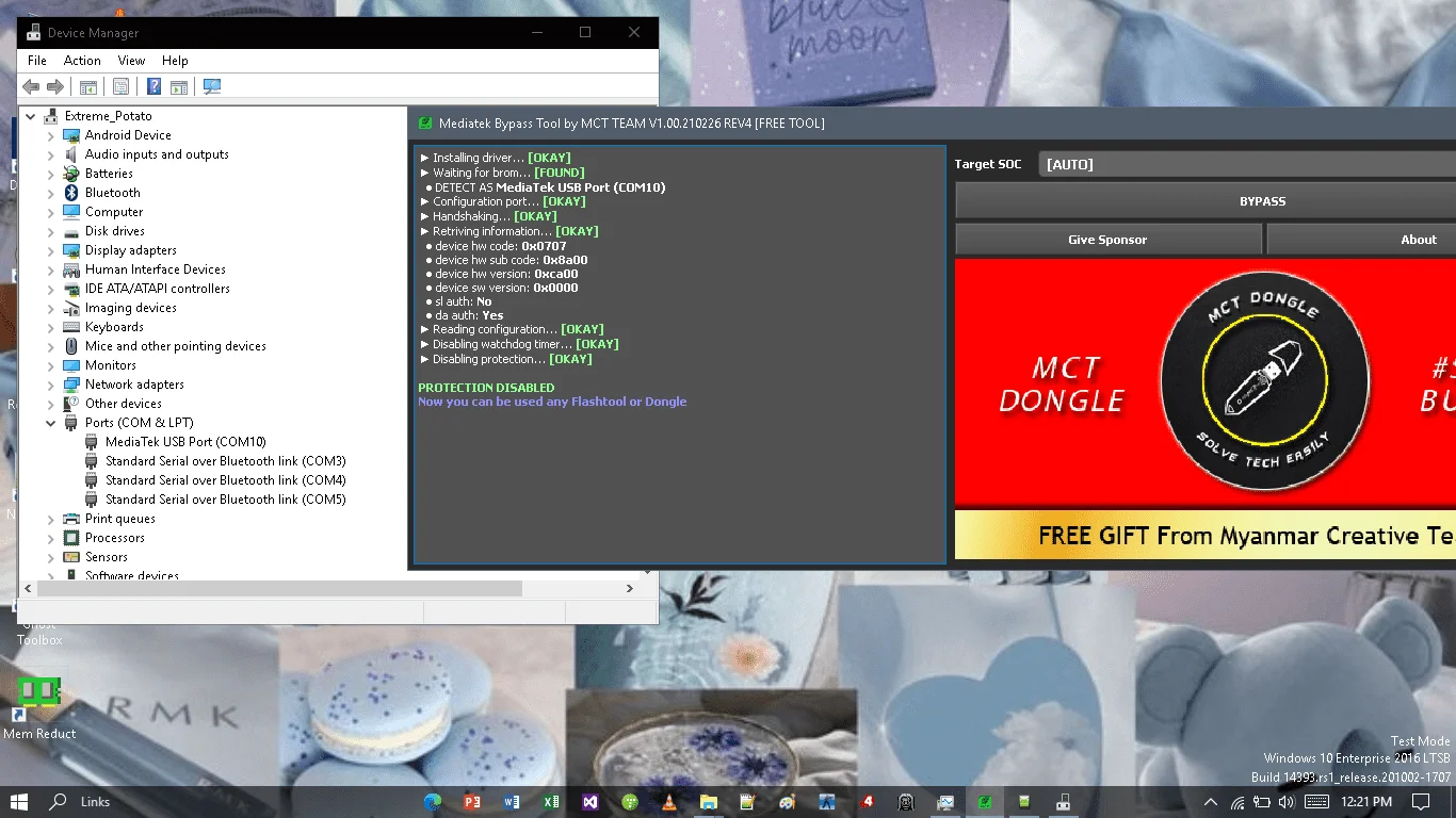

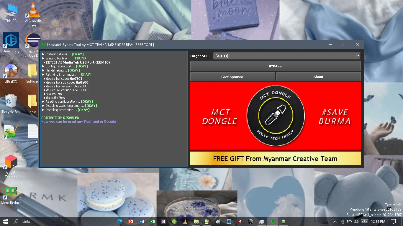

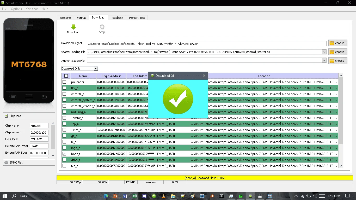

- open mct mtk bypass and click bypass connect your phone(hold both volume button(+,-) and plug usb cable).
- open device manager in windows icon or button and looked for name Meadiatek USB Port(comXX).(take note where com port no.).

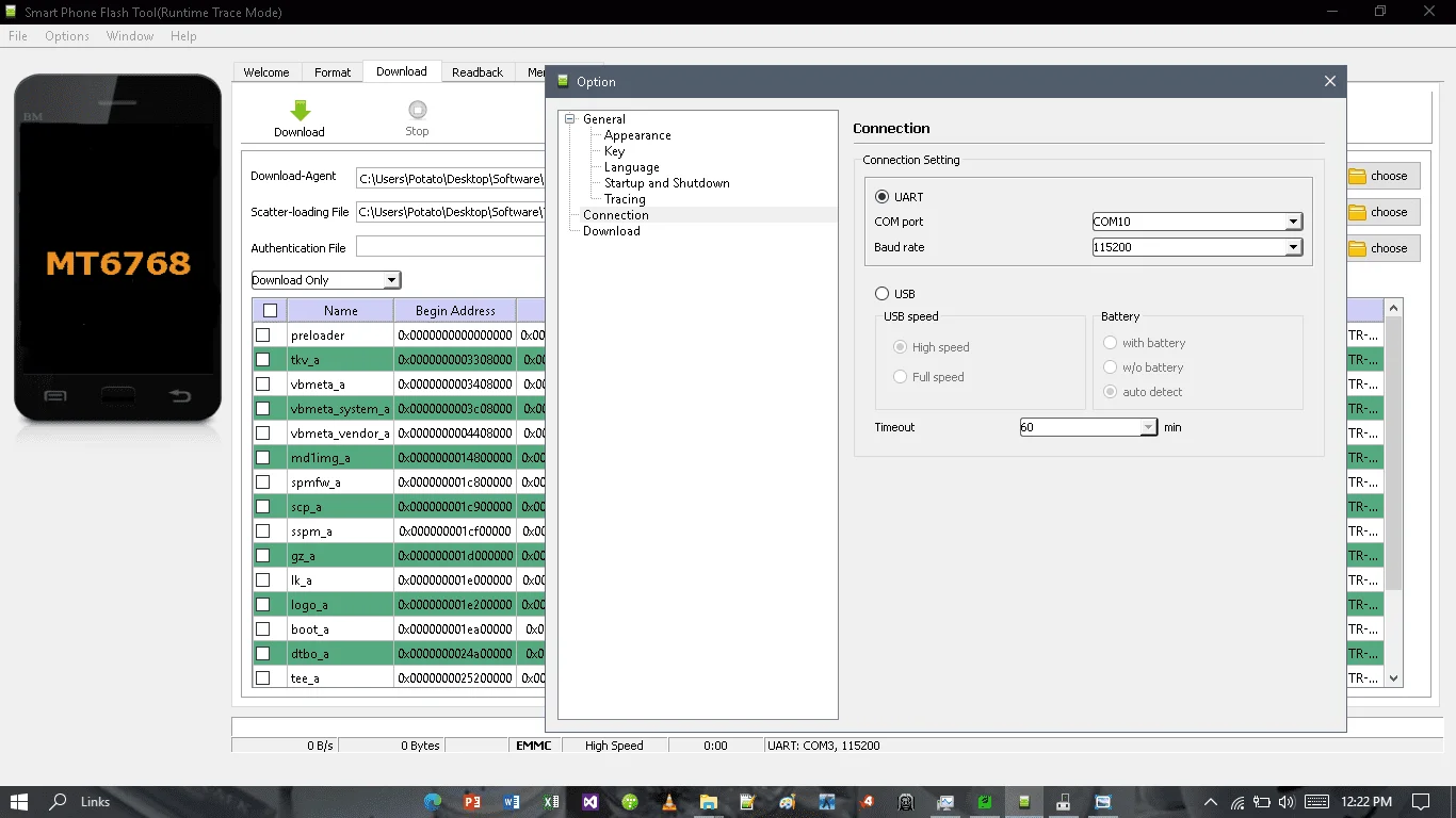

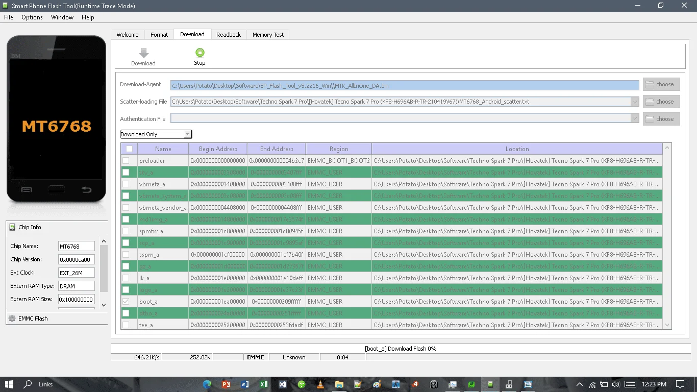

- now open sp flash tool goto option, connection tick UART select your com port no. (it must be a media usb port) and back select your scatter file check only boot and hint download button wait until complete/download ok.
- remove your usb cable and reboot to recovery mode and do factory reset and reboot

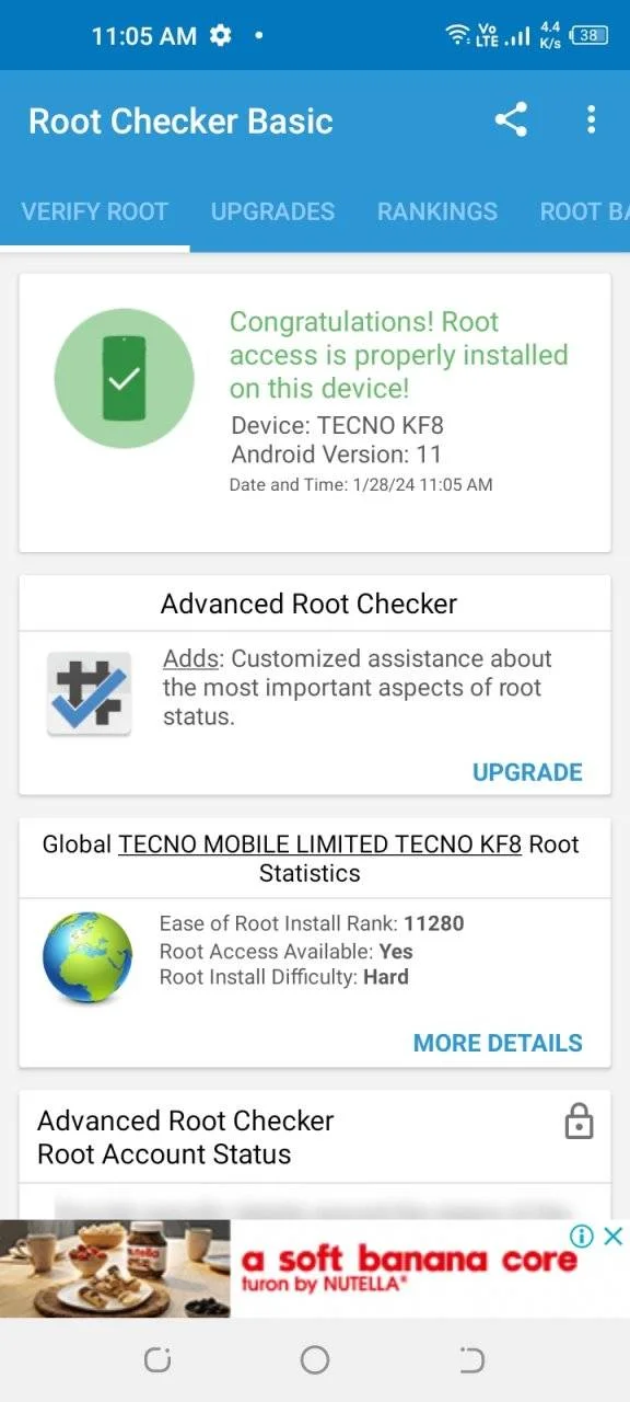

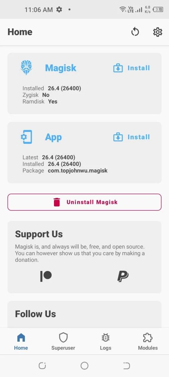

-open magisk(install some root checker if work).

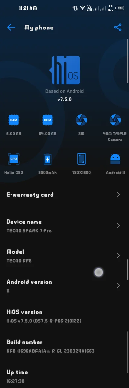

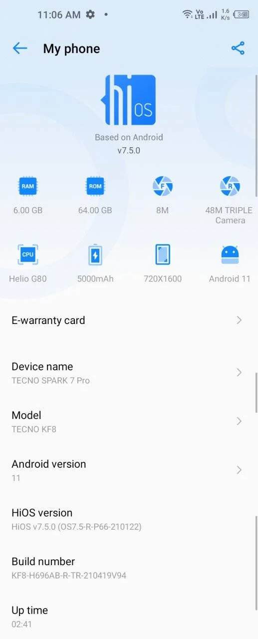

Lods gagana kaya itong saakin latest version kasi itong os ko yung pinaka huling update ni tecno
Tsaka pa mag kaiba rin tayo ng build id:
  • 11
  • 9
