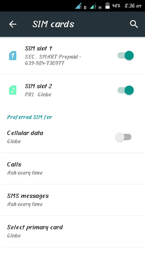

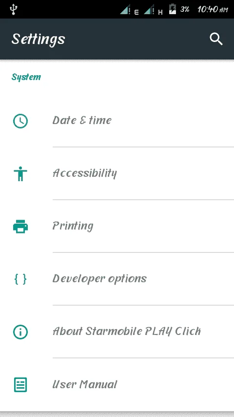

Eto na mga need para makapag open line syempre
Requirements:
Play click (your Phone)
wifi connection
pc (Computer)
first step: DL nyo ung nasa media fire then extract nyo
next step: Install kingroot need muna iroot then pag na root na install terminal emulator,
Link:
http://phcorner.org/1doaum
Ung folder na play click open line ung laman nun ilagay nyo sa sdcard nyo
Link:
http://phcorner.org/1doaxU
pagtapos nyo ma dl install ung terminal emulator:
Open then,
type nyo "su" w/o " tas enter, may mag pop up dun allow nyo lang
eto pag open line...
save mo muna ang "wfixnv1.jpb" at "wfixnv2.jpb" sa sdcard
command in terminal emulator:
su
enter
dd if=/mnt/media_rw/sdcard0/wfixnv1.jpb of=/dev/block/mmcblk0p5
enter
dd if=/mnt/media_rw/sdcard0/wfixnv2.jpb of=/dev/block/mmcblk0p6
enter,
dapat tama ung format na ganyan ha bago nyo i enter
tapos restart
openline na sya kaso iba imei eto na nxt step need na ng pc.
install nyo ung spd drivers anjan na din un sa folder may link dun kng panu install c driver.
tapos pag na install na c drivers
install nyo na si spreadtrum imei tools nasa folder din un. itype nyo lang ung ime 1 at imei 2
base sa box or likod ng phone nyo. then click write.
off nyo c phone nyo then pag na off na connect nyo sya via usb cable tas wait nyo lng na mag succes imei write at nag green na. pag ok na un tanggal c battery then kabit ulit then open mo na succes na yun.
congratz openline na play click mo
Creadit po sa gumawa,
Working po siya try nanalng sa may gusto. :D:D:D:D
