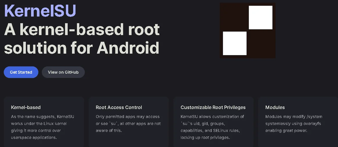

Nacheck ko kanina if supported ng KernelSU stock kernel ng Redmi Note 12 4g and pwede nga. Tested ko na rin.
Pros of KernelSU:
No need Zygisk or Magisk Hide kasi hindi to madedetect due to kernel level ang rooting method
Cons:
Hindi basta basta makakapag edit ng system files

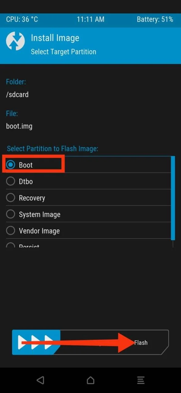

1st install KernelSU apk
Reboot to bootloader
(volume down+power button)
flash twrp_3.7.0_tapas_16102301.img using adb
Use this command:
Code:
fastboot flash recovery_a twrp_3.7.0_tapas_16102301.img
fastboot flash recovery_b twrp_3.7.0_tapas_16102301.img
after flashing, reboot to twrp(volume up+power button)
Note: Backup boot and init_boot 1st
flash android13-5.15.94_2023-05-boot.img
check boot option
