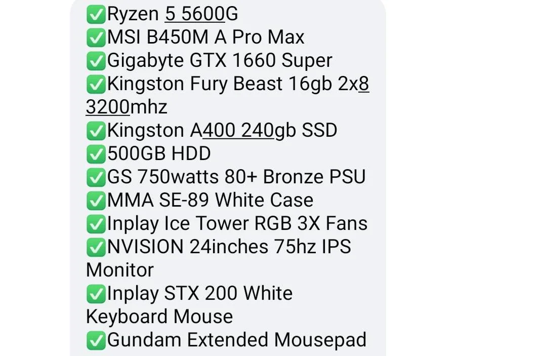

❓ Help Ok po ba tong PC Build sa 30k ?
Advise ko sayo as someone na nag work sa gilmore as sales tech, PASS SA NVISION.
Saglit lang din buhay ng nvision monitor lalo na kung heavy user ka. Tsaka 1660S? Sa ganyang price may 6600xt ka na nga eh (wag lang sa store namin kase walang sariling supplier yon so sa ibang store lang din kumukuha kaya malaki narin ang patong).
Then sa 30k pwede kana mag NVME. Mag 500GB Kingston NV2 ka (make sure lang na may emboss sya sa palagid ng lalagyan or else hindi yon original). Pero mas okay kung team group nvme kunin mo parang mas mura.
Tas yung kb/m, kung budget meal lang hanap mo, mag Nexion 4in1 ka nalang. Around 1800 lang din yon pero kompleto na yon from headset to mousepad. Mechanical narin (blue switch) so mejo okay narin ang gaming exp.
Overall, okay narin para 30k kung set pero not the best choice. Para mas makamura ka, mas magandang ikaw mismo mag canvas ng parts mo. FB marketplace marami din good deals don pero ingat lang scam. Item
muna bago pera dapat.
change the following:
1. processor, since may discreet GPU ka naman, you don't need a "G" processor (a Ryzen 5 5600 will do)
2. monitor, get a much known brand like AOC, HP, MSI, Asus at LG (kung kaya ng budget)
3. PSU though it's already an 80+ bronze certify, pero wala akong tiwala sa brand (Darkflash)
4. HDD, masyado nang outdated ito in terms of reading speed and write, instead get a 256gb M.2 NVME as your system drive and 500gb SSD as your storage drive
Thank you for providing the details of your PC build. Overall, it looks like a solid mid-range gaming setup. Let's go through each component to see if any upgrades are necessary:
1. Ryzen 5 5600G: The Ryzen 5 5600G is a good processor that offers excellent performance for gaming and general tasks. It has integrated graphics, but since you have a dedicated graphics card (GTX 1660 Super), you won't be relying on the integrated GPU. Therefore, there is no need to upgrade the CPU.
2. MSI B450M A-Pro Max: The MSI B450M A-Pro Max is a decent motherboard that supports the Ryzen 5 5600G and provides enough connectivity options. It should serve you well, and there is no immediate need to upgrade.
3. Gigabyte GTX 1660 Super: The GTX 1660 Super is a great mid-range graphics card for 1080p gaming. It should handle most games at high settings without too much trouble. However, if you plan on playing more demanding games or want to future-proof your build, you may consider upgrading to a more powerful graphics card in the future.
4. Kingston Fury Beast 16GB 2x8 3200MHz: 16GB of RAM is sufficient for most gaming and multitasking needs. The 3200MHz speed is also good for Ryzen processors. No immediate need to upgrade here.
5. Kingston A400 240GB SSD + 500GB HDD: Having both an SSD and HDD is a good combination. The SSD will provide fast boot times and quick access to frequently used applications, while the HDD will offer more storage space for games and files. Depending on your storage needs, you can consider adding more storage in the future.
6. GS 750W 80+ Bronze PSU: A 750W power supply is more than enough for your current build. It provides room for future upgrades as well.
7. MMA SE-89 White Case + Inplay Ice Tower RGB 3XFans: The case and fans you've chosen should provide adequate cooling and aesthetics for your build. No need to upgrade unless you have specific preferences.
8. NVISION 24-inches 75Hz IPS Monitor: A 75Hz IPS monitor is a good choice for gaming and general use. However, if you want a higher refresh rate for smoother gameplay, you may consider upgrading to a 144Hz monitor in the future.
9. Inplay STX 200 White Keyboard + Mouse: The Inplay STX 200 keyboard and mouse should serve you well for general use and gaming. If you prefer mechanical keyboards or higher-end gaming mice, you might consider upgrading in the future.
10. Gundam Extended Mousepad: The extended mousepad is a nice addition for comfortable mouse movement. No need to upgrade unless you have specific preferences.
Overall, your PC build seems well-balanced for mid-range gaming. There are no immediate upgrades needed, but you can consider upgrading the graphics card in the future if you want more gaming performance.
bat parang ᑕᕼᗩTGᑭT to 😂
PROS: Performance is equal to a RX580
CONS: No more driver support, last driver is almost 2years old
Very high TDP. parang dalawang RX 6600 ang power consumption mo.
Yes. Any PCiE GPU will work on any motherboard with PCiE slots.
power hungry pala yan . nakita ko kc sa fb market place gnamit sa gpu mining 3k lang . pull out
Kung mag AM4 ka, mag ryzen 5600 ka mas mura kesa sa 5600x, almost same performance lang. Try mo din ilagay lahat sa pcpartpicker lahat ng parts mo para makita recommended wattage ng power supply, mas maganda mag branded ka na PSU.
Ikaw na mag build ng pc mo, pag di marunong pa build mo sa mga kakilala mo abutan mo na lang kahit 300-500 kesa sa mga pre build sa mga shop, puro chinese made yung ilalagay nila. Tsaka wag mo isipin na wala ka pang pc, mas másáráp mag build kapag unti-unti.
Dun naman sa 5600g wag ka na bumili ng igpu kung mag gtx1660 ka, gawin mo kung tight budget ka bili ka ng 5600g then ipon ka bili ka ng rtx 30 series up. Gtx 1660 after 1-2 years halos rtx 20 series na mababa after nyan
