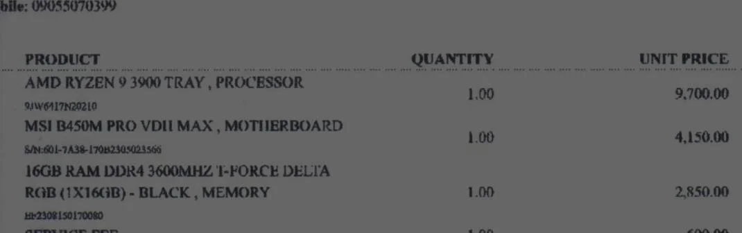

Kaw nalang mag build mas makaka tipid ka pa at mas mataas pa specs na makukuha mo. Bigyan kita nh quote, kaka upgrade ko palang. Though wala itong gpu kasi meron na akong gpu na rtx 2060. View attachment 2856020

kung brand new yan, price is very good. but the PSU and M/KB are both generic. still price is very good.
brand new sir, 1 year warranty din po. sa psu nga ko nag aalangan sir ei, saka sa ssd parang medyo mababa.
pa upgrade ko n lng po sknya dagdag na lang ako tapos gawing ryzen 5 5600x

lugi na din ksi sila kung tataasan pa nila ang SSD. infact sa mga reputable stores, 30k na yan CPU pa lang. di pa kasali monitor. im referring to the exact same specs to price by item.

ang mura nga po sir e tas medyo ok after sales nila base sa review, sa gpu pa lang ok na for mid range. plus may monitor and peripherals na rin although nvision pero sobrang sulit pa rin.

ok nmn ang Nvision. sakin 3 years na eto pa rin gamit ko. anyway ang GPU na yan is far from mid range. budget range lng yan.
kung around 30k lang budget mo, better get Ryzen 7 5700G, as long as solid components mo, you can always do upgrade down the road. secure mo lng PSU. kahit next time na GPU.
