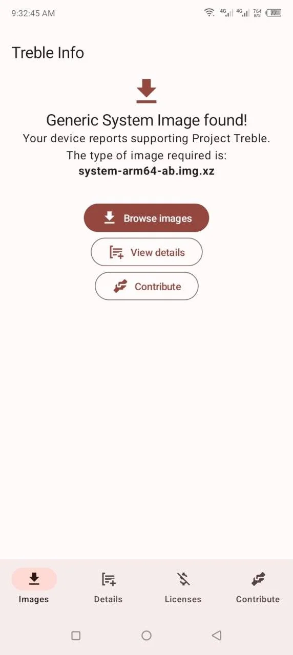

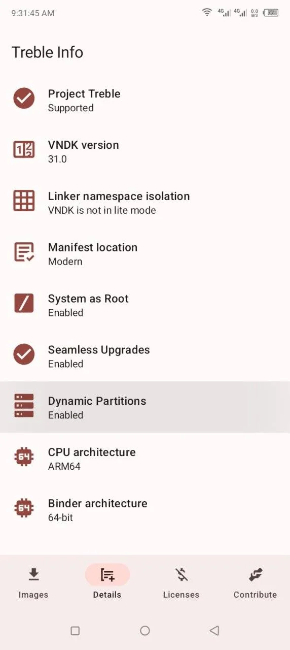

• Device with Dynamic Partition supported (Install Treble info: Google Play, or You do not have permission to view the full content of this post. Log in or register now.)
• A GSI ROM you want to use*
*Before using a GSI, you must carefully check the GSI you choose if your device is Treble compatible with your architecture, if it has system as root (A/B), what VNDK version is (Android version), what VNDK implementation is (if it has VNDK lite or not), and more importantly, Dynamic Partitions must strictly enabled out-of-the-box. To know more about your device on choosing a GSI properly of what device supports it, install Treble info on Google Play, or You do not have permission to view the full content of this post. Log in or register now..

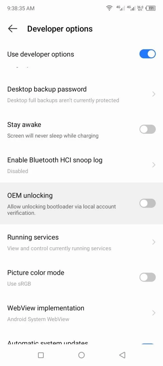

  • Developer Options must be enabled, then
  • Turn on USB Debugging and OEM unlocking

  • Requires to Unlock Bootloader after enable OEM unlocking
Booting a GSI image through Dynamic system on a Locked Bootloader will cause fail to boot, causing the system will appear corrupted system or boot itself back to the original system. In order to bypass booting a GSI on your device, please ensure you must unlock your bootloader, referred to the other guides on the web depending what brand of your phone you're using. Be sure you must enable OEM unlocking before using Fastboot on unlocking the bootloader.

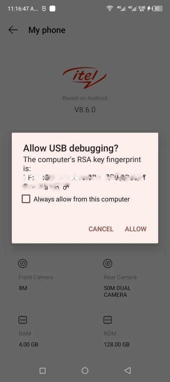

To use ADB commands (requires PC) for the steps below, you must enable USB debugging in Developer Options. You must have familiar on using ADB commands installed on the PC. Please refer the other guides on how to use it.

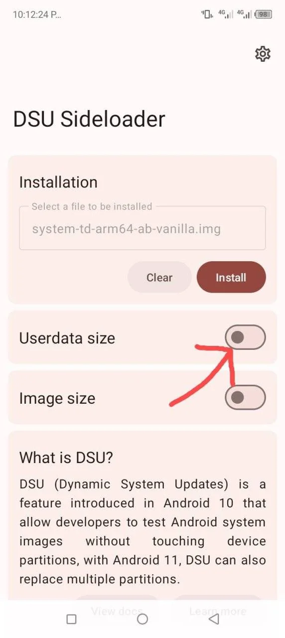

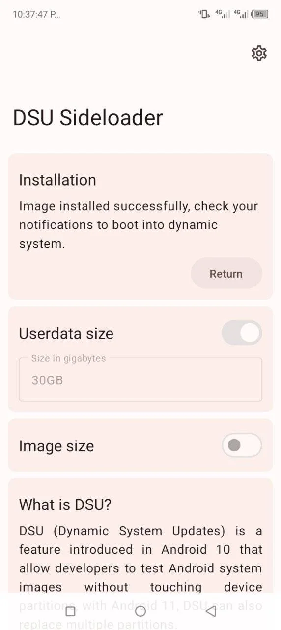

Step 1: Install and Setup DSU Sideloader

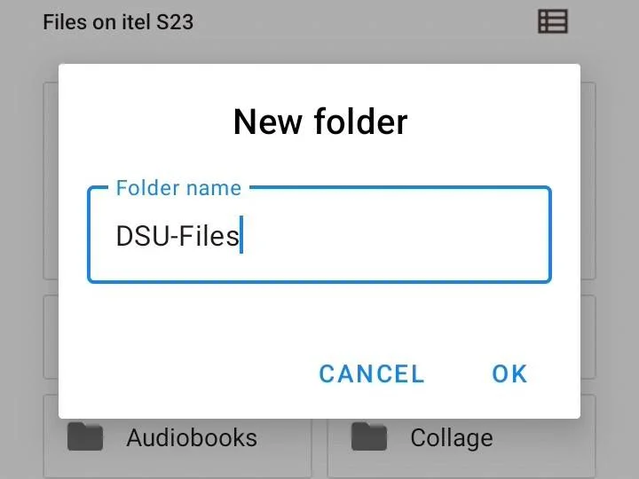

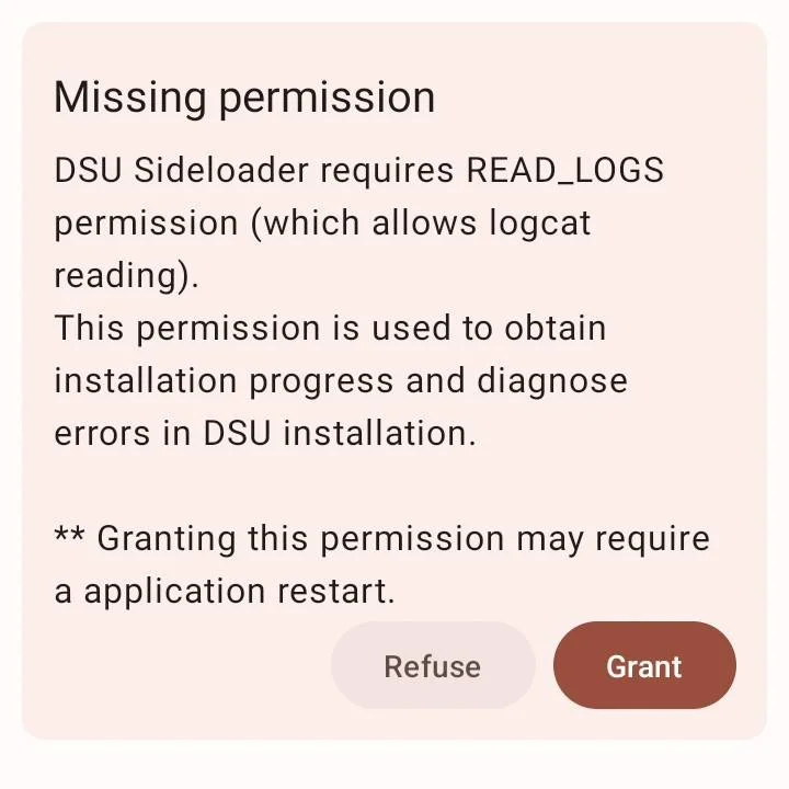

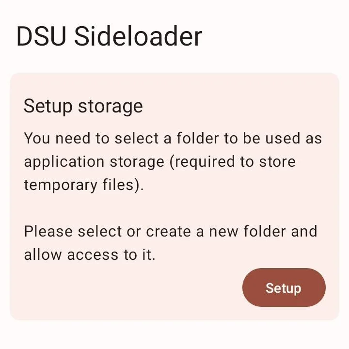

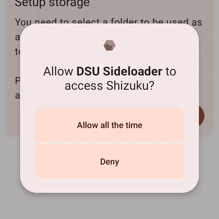

Install DSU sideloader and open it. It may prompt you to allow Shizuku permission and other pemissions (READ_LOGS).

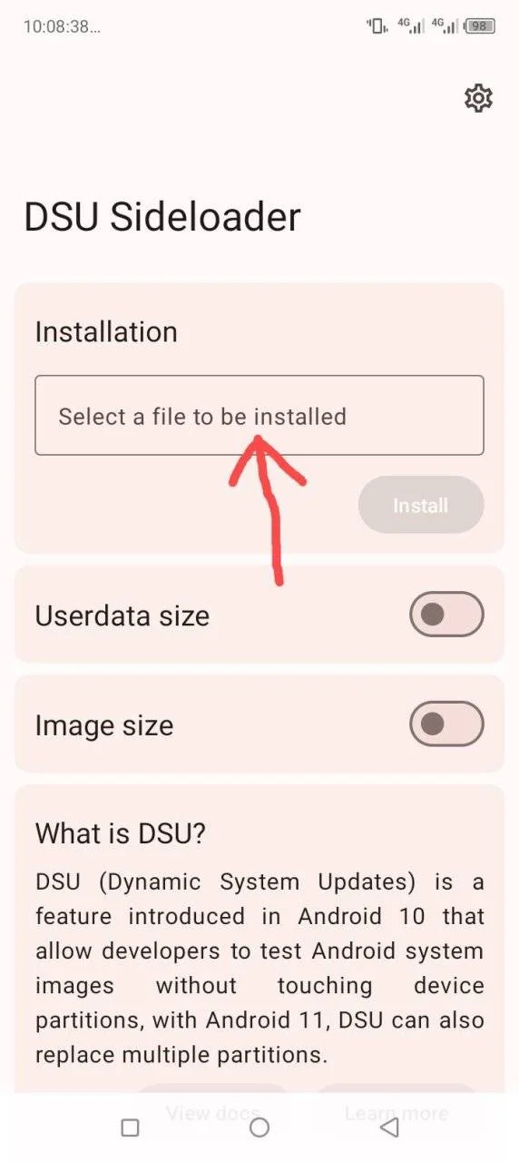

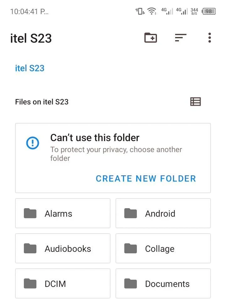

Please allow these permission, create a new folder, and select the folder you created to use DSU sideloader. (See image)

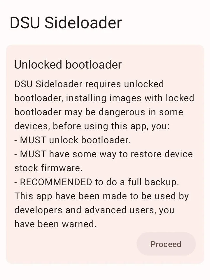

Then you will see an info about Unlocked Bootloader and other notices. Press proceed to continue. (See image)

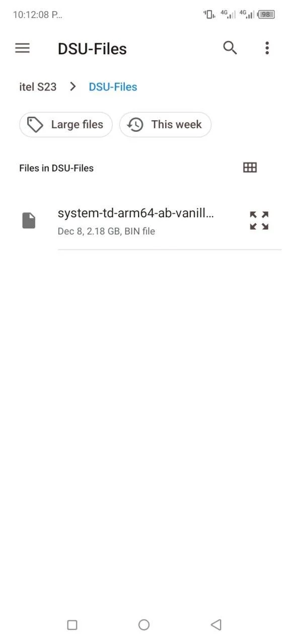

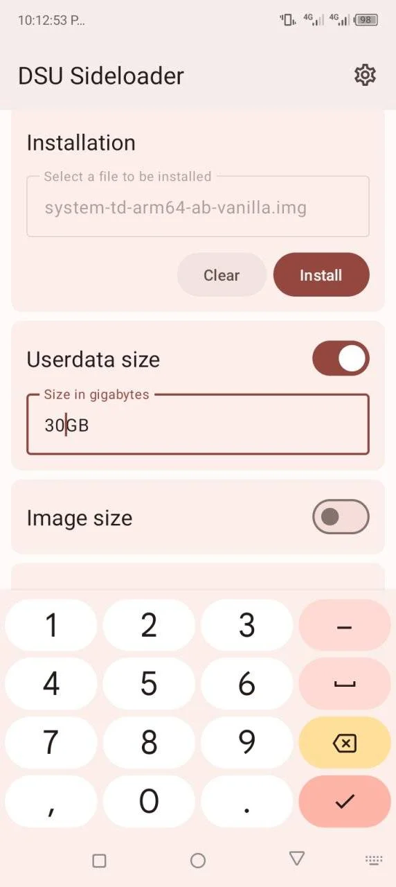

Step 2: Select only one GSI image you have
• Supported file formats: *.img.xz, *.img.gz, *.img, *.You do not have permission to view the full content of this post. Log in or register now.
Step 3: Customize your Userdata size
You can allocate your size of the Userdata of your choice. My recommendation is 10GB or above. *Requires a lot of free space on your internal storage on allocating userdata for DSU.

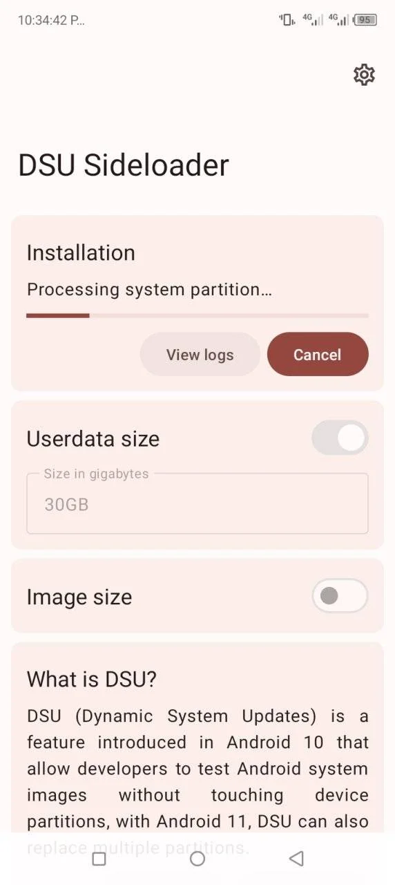

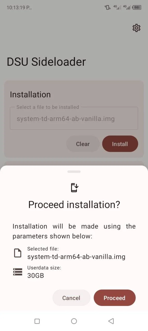

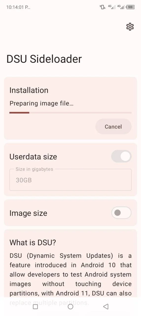

Step 4: Proceed installation

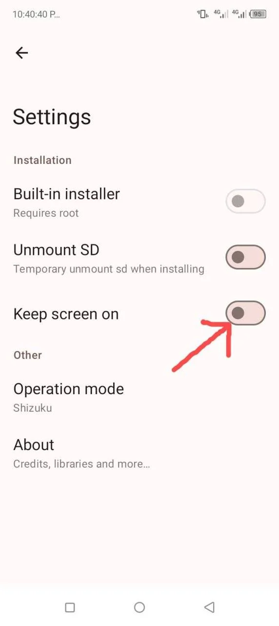

After selecting a GSI image and the right size of the disk, then proceed the installation. Make sure your screen must be always on to avoid interruptions.
Please be patient while preparing to be compressed the GSI image.

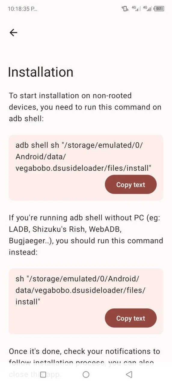

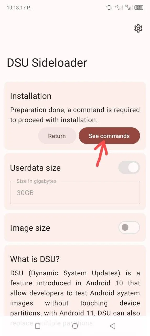

For ADB users: After finished preparing the GSI image, it will prompt you to run the command. Press See commands. And then run the adb shell command of the following (See the image) to continue the installation.
There is a final procedure if you have a screen lock enabled, please enter a correct pattern, PIN, Password, or your fingerprint/face unlock to allow Dynamic System Updates to continue the installation.

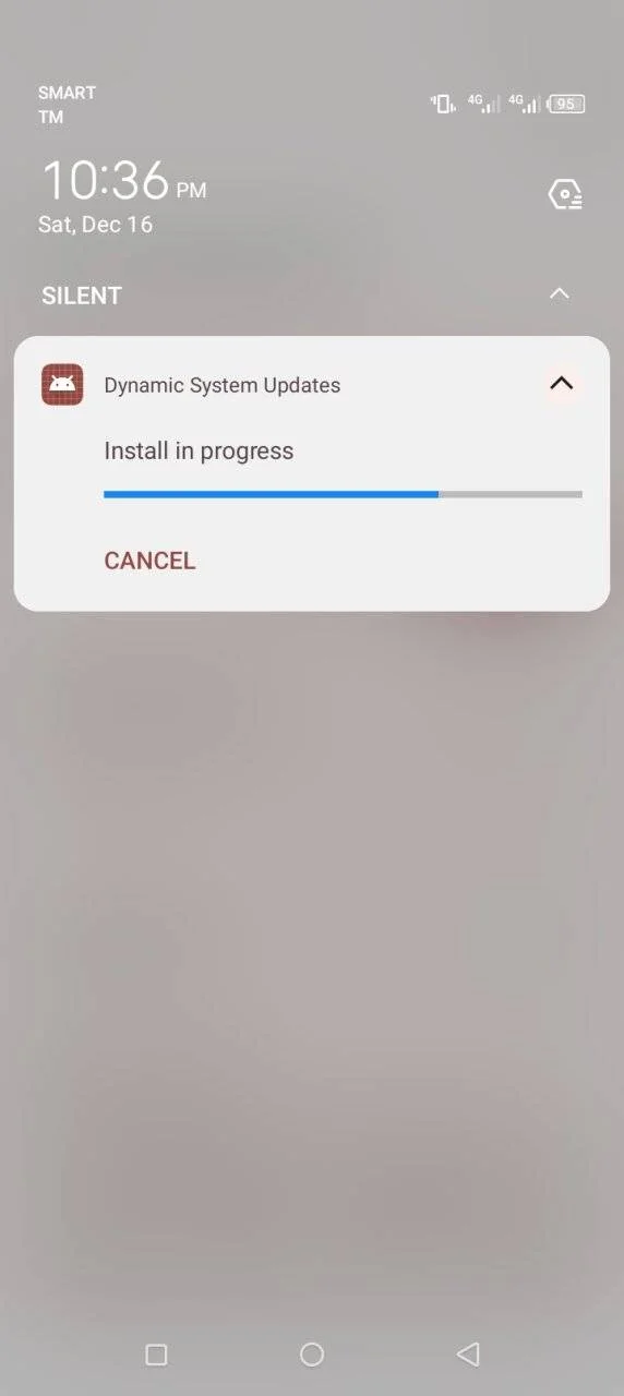

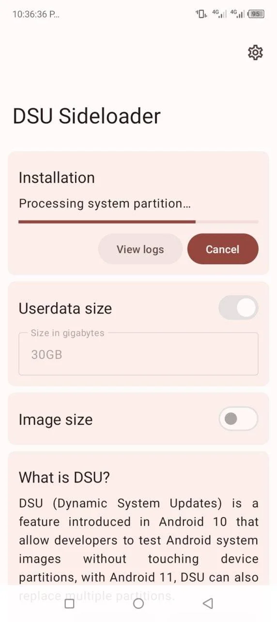

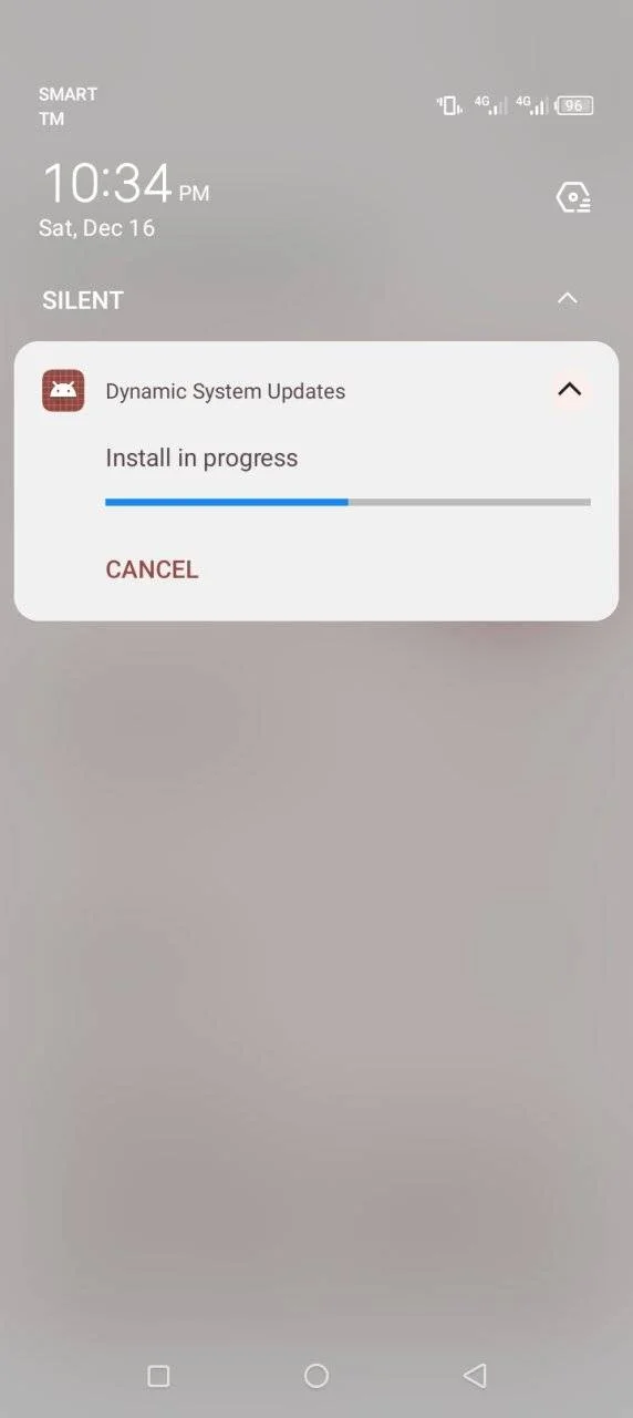

As you can see, the DSU installer starts installing your GSI image in notifications. (See image) Please wait until it finish the installation.

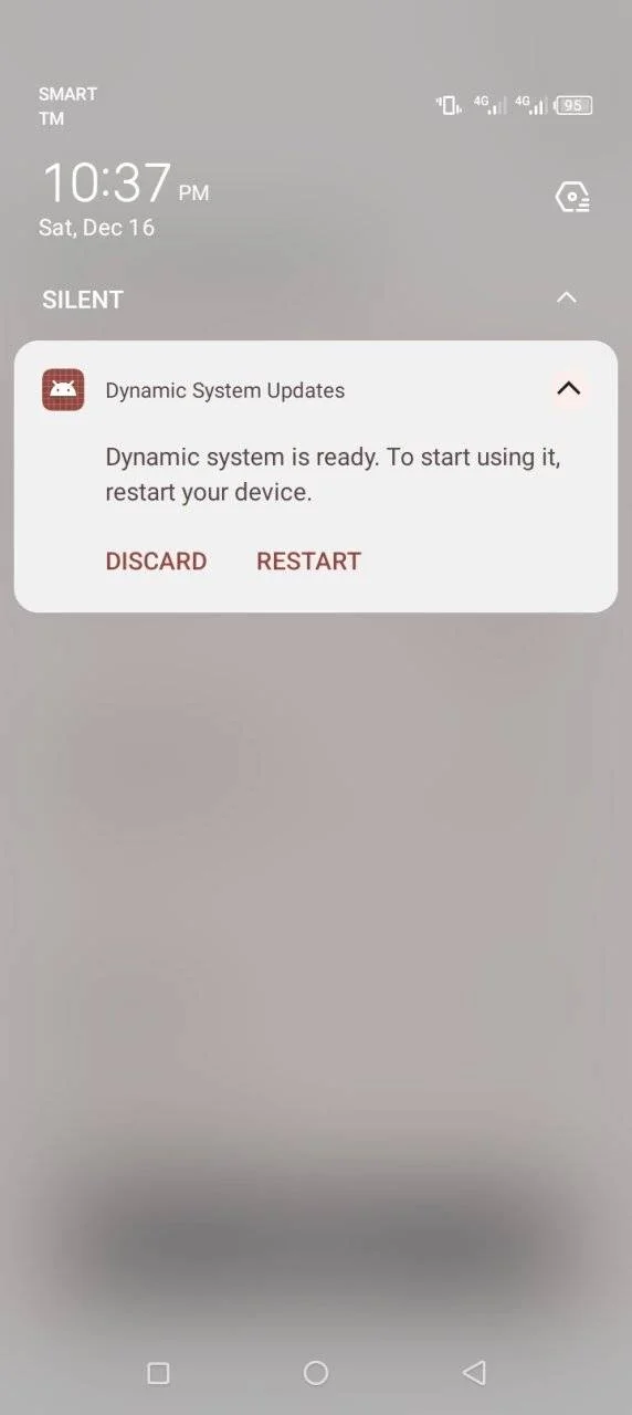

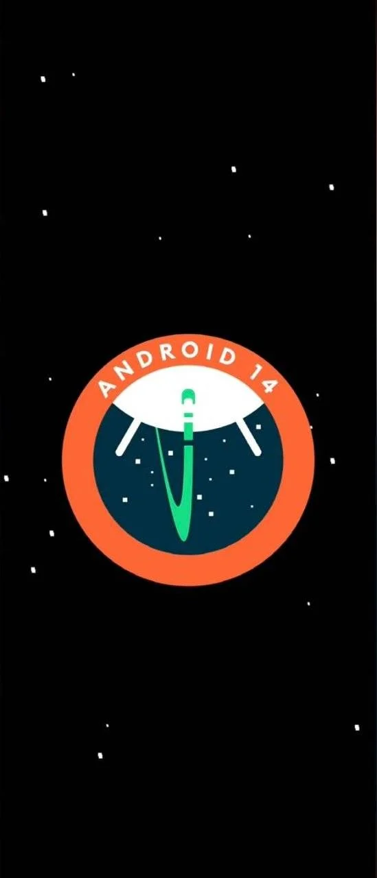

Congratulations; the DSU installation is completed. Please check the notifications, and its ready to use your GSI ROM on your device. To boot into Dynamic system you created, click RESTART.
To delete the dynamic system you created, click DISCARD. This will delete the installed GSI and local data stored inside the Dynamic system, and free up your storage space.

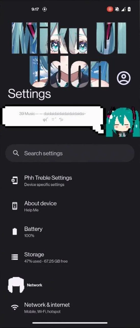

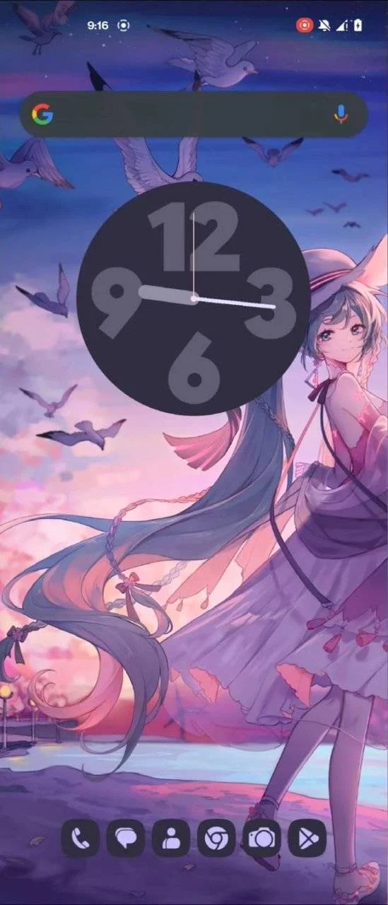

Which GSI ROMs do you like?

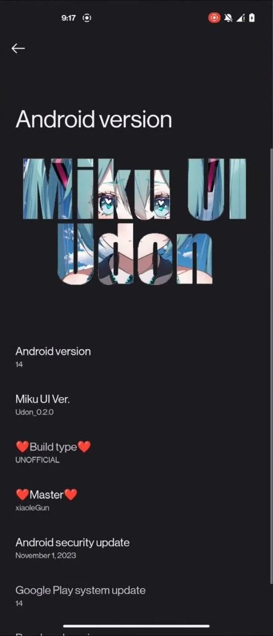

- Miku UI (Sample image)
