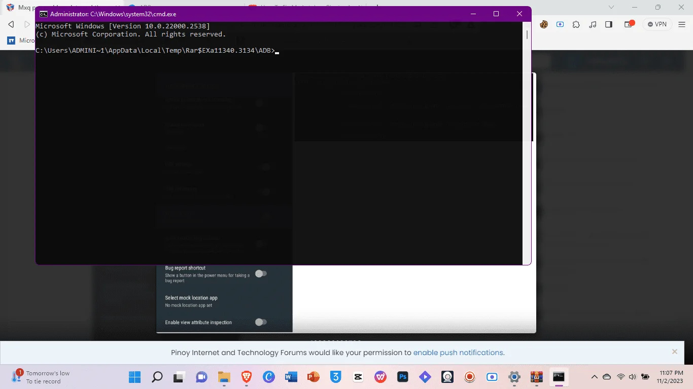

ano next dito?

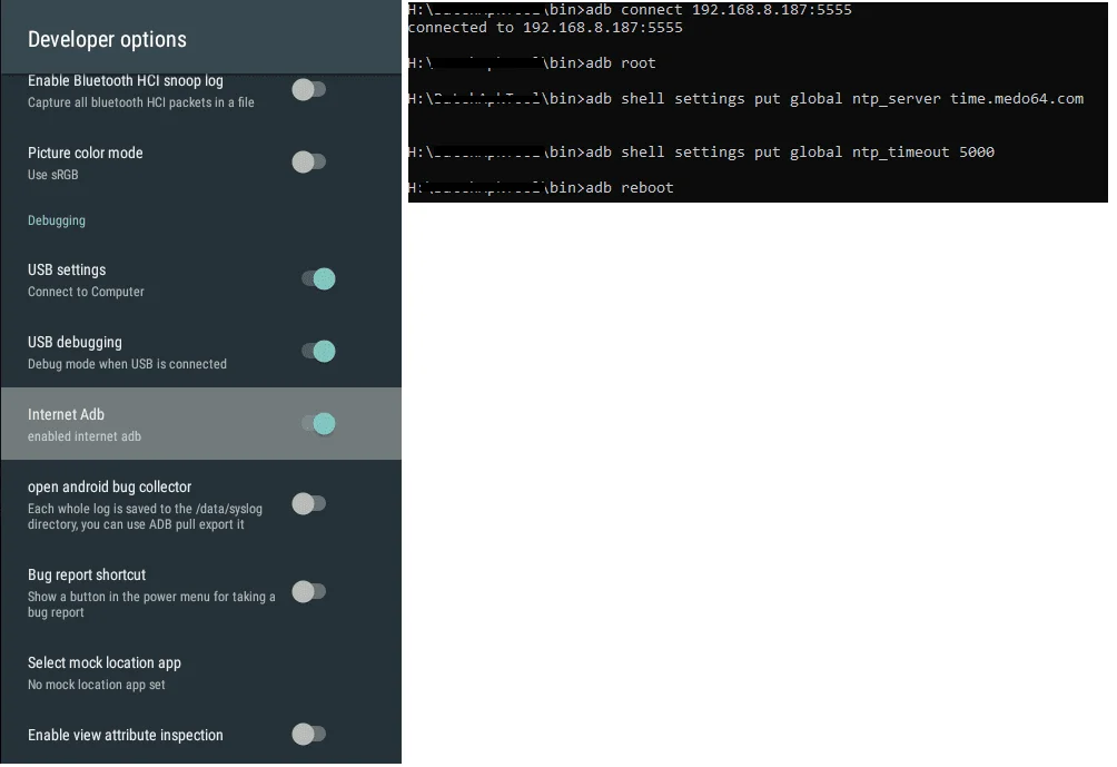

enable developer option
enable nyu internet adb then connect..
adb connect 192.168.X.X:5555
or
USB adb "kelangan ng Male to Male USB"
para ma fix ung date and time problem eto
command to execute:
adb root
adb shell settings put global ntp_server time.medo64.com
adb shell settings put global ntp_timeout 5000

Pag walang male to male usb i on mo nlang po ung internet adb sa developer option
Tapos sa pag connect
Ipadrress ng tvbox then port
adb connect 192.168.x.x:5555
adb root

Need pc ba boss?
Ok here's the rundown how to solve this issue:
1. Using PC you must download the Android SDK Platform Tools (Just google it)
2. To install SDK watch here: You do not have permission to view the full content of this post. Log in or register now.
3. Make sure you follow the installation process including the editing of the rules on how the adb will run on all folders
4. Open CMD
5. Test if adb is working by typing adb on cmd and hit enter
6. If all functions of adb are shown that means it is now working
7. Turn on your Android device/stick and enable developer settings(if you don't know just google it)
8. Access the Developer settings turn on "internet adb"
9. Now go to network settings of your Android device and browse check and note the IP address of your device
10. Go back to cmd and type: adb connect 192.168.x.x:5555 (where x is the exact number found in your IP address)
11. type: adb root (wait until it says it is running on root)
12: type: adb shell settings put global ntp_server time.medo64.com
13. type: adb shell settings put global ntp_timeout 5000
14. Completely turn off your Android Device - unplug it.
15. Turn ON go to settings and date and time select auto sync time
16. Go to Time zone - select either Kuala Lumpur, Hongkong, Singapore, Teipie
17. Check if date and time has change if not, Restart the device that will work.
