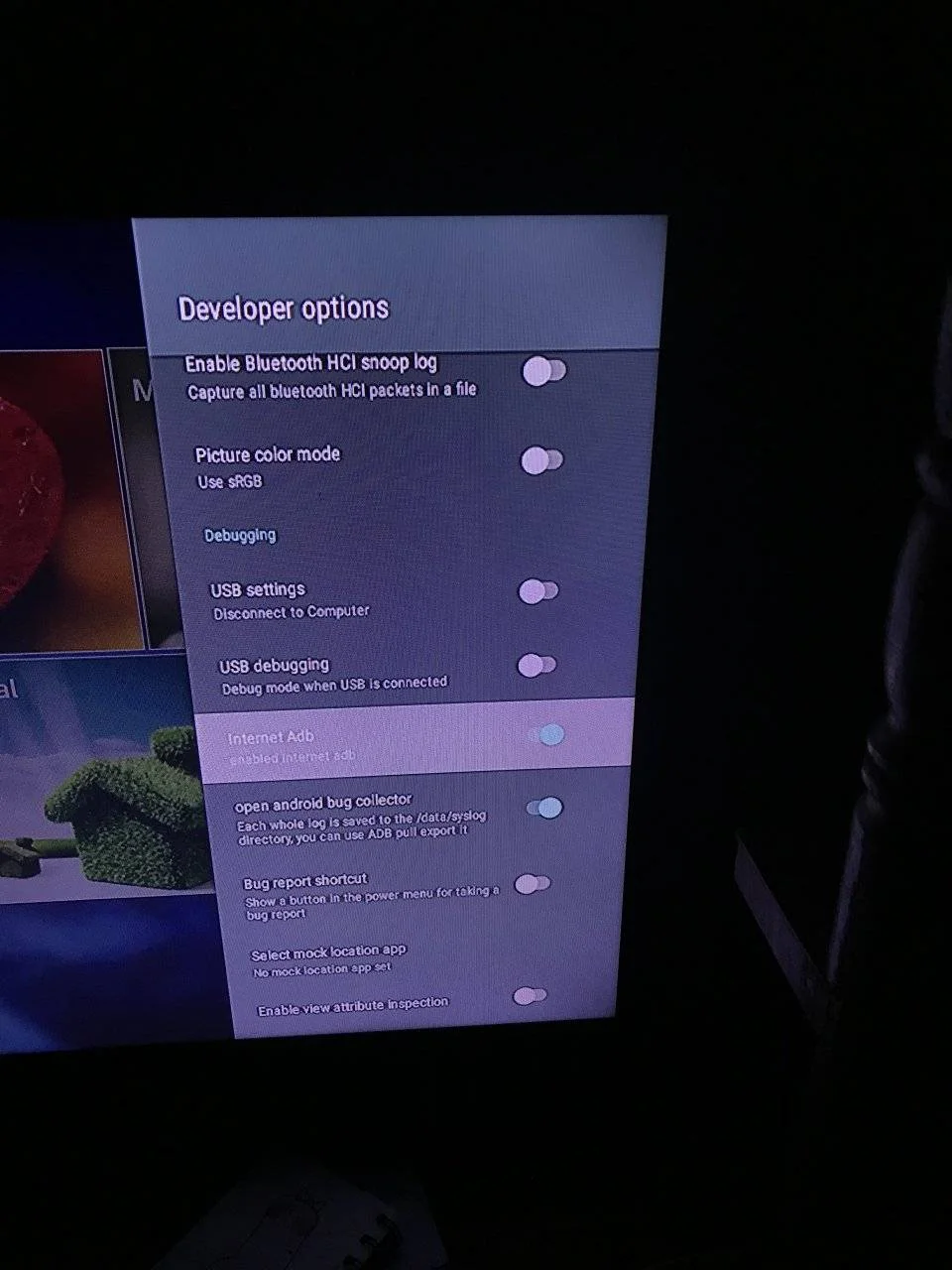

Pahelp naman kapag binubuksan ko mxq hindi sya nag aautomatic sa time kahit naka wifi naman. Kailangan pa imanual, nakakapagod na tuwing mag oopen ako. In format ko na din ayaw padin. Noon okay lang naman, ewan ko kung ano nangyari.
Solve na ba to ?
Eto inaantay nyung Solution via ADB
enable developer option
enable nyu internet adb then connect..
adb connect 192.168.X.X:5555
or
USB adb "kelangan ng Male to Male USB"
para ma fix ung date and time problem eto
command to execute:
adb root
adb shell settings put global ntp_server time.medo64.com
adb shell settings put global ntp_timeout 5000
Solve na ba to ?
or
command to execute:
adb root
naka enable na, tapos pano icoconnect?
