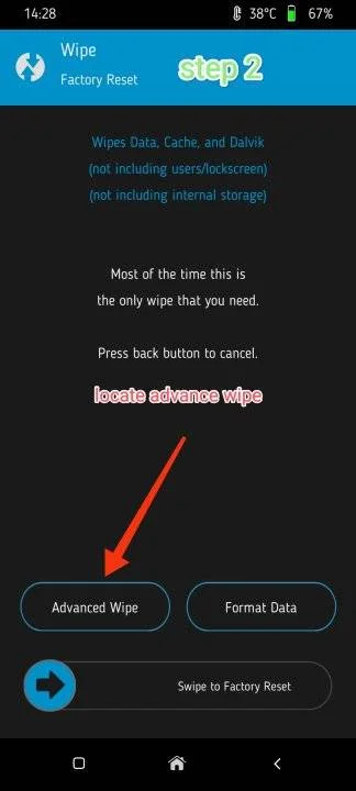

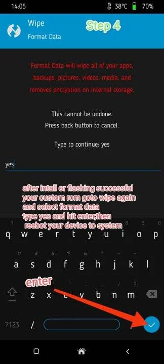

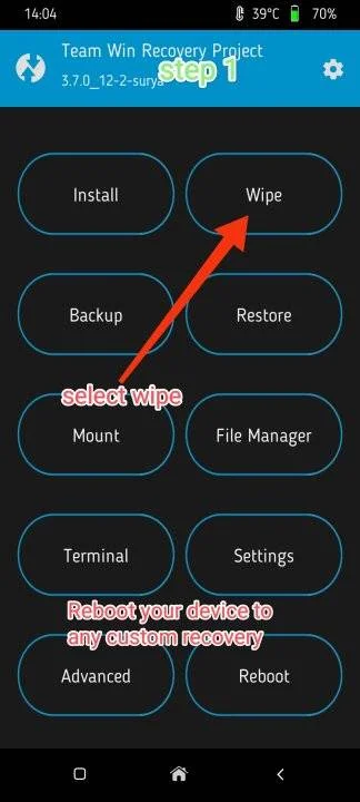

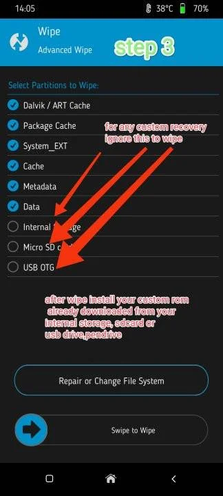

👨‍🏫 Tutorial Flashing Any Custom Rom 100% no error or bootloop
migz26
Forum Guru
•For advance user
•Already Install Any Custom Recovery on your Device
ScreenShot Guide:
IMG_20230824_192640.webpIMG_20230824_193544.webpIMG_20230824_194353.webpIMG_20230824_195206.webp

I flash mo lang ang VDFE_20221003.zip ,pag katapos mo mag successful mag flashing ng custom rom mo at mag format data.

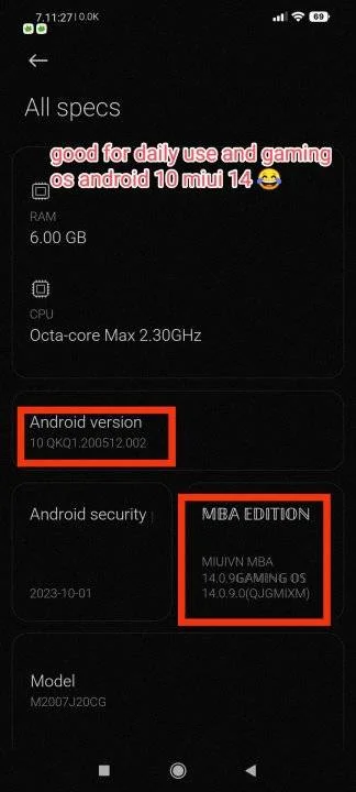

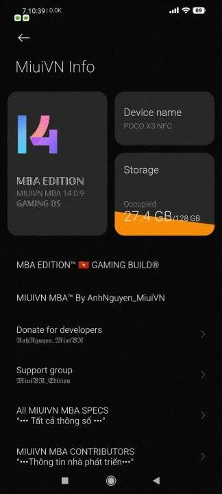

My device:
•Poco x3 nfc Surya with custom rom Gaming Os
•Root with magisk safety net pass
Anong Custom rom Niyo mga par

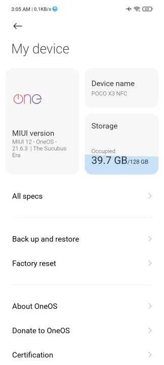

Nasubukan ko yan na custom rom lodi maganda yan MBA EDITION pag daily use, optimize sya battery pero pag sa gaming medyo nag fps drop. Subukan mo mag One OS 21.6.3 maganda sa gaming at battery.

Boss pa help namn. Same device tau. current rom ko ngayon ay Aosp na rom Crdroid na lates Yung Android 14, tapos gusto ko sana ibalik sa dati kong custom rom na MIUI GT, kaso na bobootloop palagi. D ko alam anong mali na nagawa ko. Wipe ko nman yung 5 na(dalvik, package cache, cache, metadata, data) d ko winawipe yung system ext. Need ba talaga iwipe yung sytem exit? Need ko ba eflash yung permissive V5 na file? Pa guide namn boss.
wag mo wipe boss, flash custom rom tas format data tas reboot na if di gumana baka need mo mag upgrade or downgrade ng miui, tanong ka rin sa tg group nyo.
