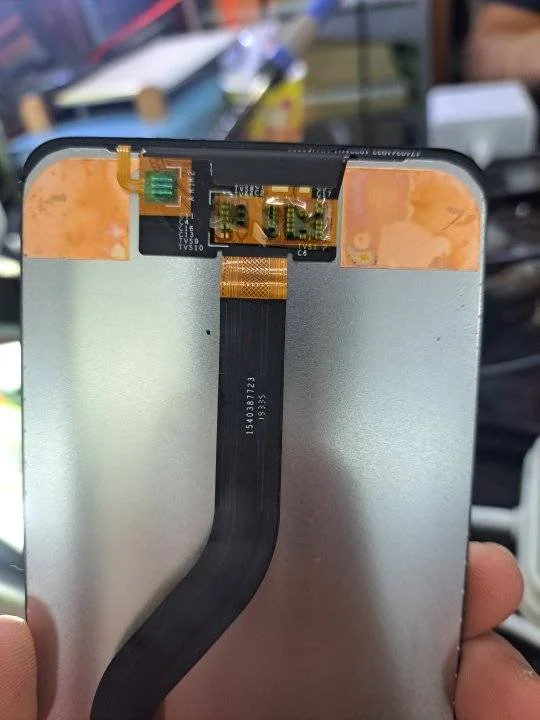

Hi PHC robot as checked by my tech friend, water damaged sya, we see water marks and rust sa screen digitizer, What with did is replace the whole screen, and viola wala ng screen Freeze, Thanks
I'm glad to hear that the screen freeze issue was resolved after replacing the whole screen! Water damage can indeed cause various issues, including screen freezing and other malfunctions. It's great that your tech friend was able to identify the water damage and take the necessary steps to fix it.
Water damage can corrode the internal components of a phone, leading to malfunctions. In this case, the presence of water marks and rust on the screen digitizer likely caused the screen freeze problem. By replacing the screen, you removed the damaged part and restored the functionality of the device.
If you encounter any other issues or have further questions, feel free to ask. I'm here to help!
